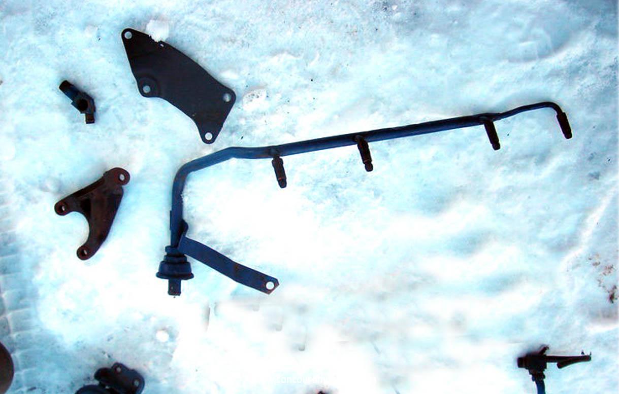

So this is what I am commonly finding out there in the market place. This pair was reported to have been personally removed from a 67' 390 Cougar. It is the tube that swings out front that Bob is mentioning and showing that I never seem to find. In pictures of restored cars, it is in THAT tube that the check valves are incorporated in. The tubes I am showing has check valves on the manifolds themselves.    :o
The ones in the pictures are the driver side and the short one with the valve done close to the head at the back/firewall side is the passenger side these are the ones used on a 67 GT500. The other BB style which was not used on any Shelby had both sides with the valve down low by the head.  The last person that I had looking for some I directed to ED Meyer (Special ED) . I don't know if he has anymore as he only cares about 69/70 cars  :o

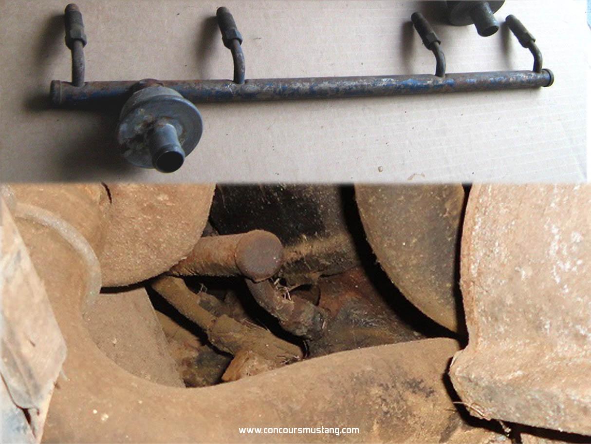

Those are not tubes that were typically used on San Jose built Cougar and Mustang 67's at least that I've ever seen, owned or seen in pictures.

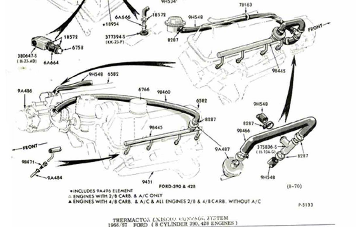

That style was used on T birds, Galaxies, trucks and the like as shown in the Ford drawing

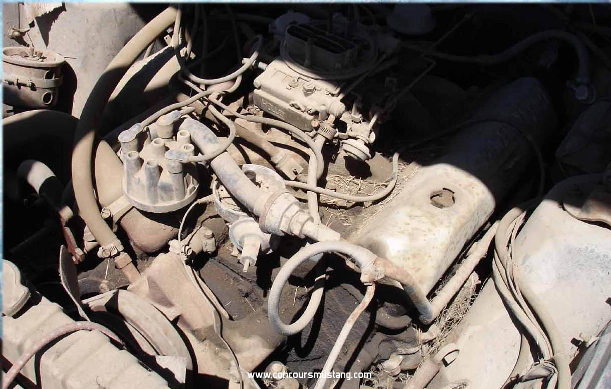

67 big block pipes look like these originals (Cougar and Mustang examples)
The check valves screw on to the end of each of the tube manifolds. They are a separate piece
Might want to look at the bottom one again  - looks to be a T bird pipe/manifold since check valve is located at the front of the engine behind the pump. Give away is the way the smaller secondary tubes are shaped
His bottom tube compared to the curvature of an original with the check valve at the rear.  Real easy to miss when the parts are off the car just sitting there

Jeff,
Do you have a schematic like the one above for Mustangs?

Jeff,
No the MPC I have with the somewhat generic drawings do not have the 67 Mustang application - only big Ford (390-428) , Fairlane (390)  and the PI (427) for 67 big block applications. Interesting that they included the 67 289 Hipo drawing since its a 4 month only thing

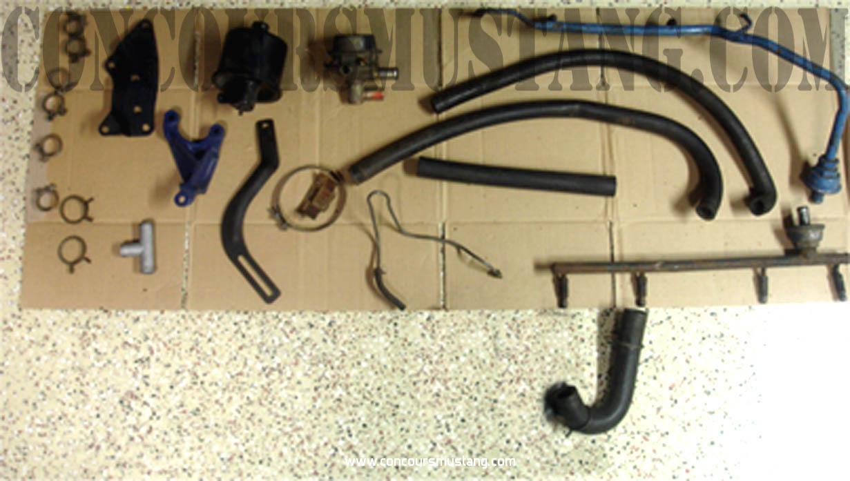

Here is a general shot of the parts that make up the system - again some will not be used if you have a car built during certain times. Note:
- that the drivers side manifold is not the correct one for the application
- the picture does not show the pump, pulley or any of the mounting bolts.
- There are three large diameter hoses missing and the small rubber vacuum hose not shown
- And that is NOT a factory paint mark on the diverter valve ;)
Guess I should get it all out again and take a complete shot of all the pieces for a better reference picture

Jeff,
I have that schematic, but I see at least two versions 11/66, and 2/67 revsion for some of the hose routngs
Those schematics will not help for a GT500 application because the installer would have to know what things are for GT500 and what aren't . a catch 22.  It would be helpful for someone like myself to remind which way a few of the clamps are positioned but that would be it. Not anything in print on the GT500 that is much help. We have to go by personal observations mostly.

The alternator adjusting bracket is not correct for GT500 application. The correct one has a another bend to clear the large diameter GT500 /police intercepter balancer.
My comments were in reference to the long tubes in the picture that I posted not another. The short one I write about is not in the picture but just a written description.
