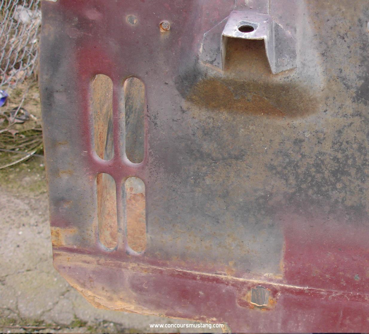

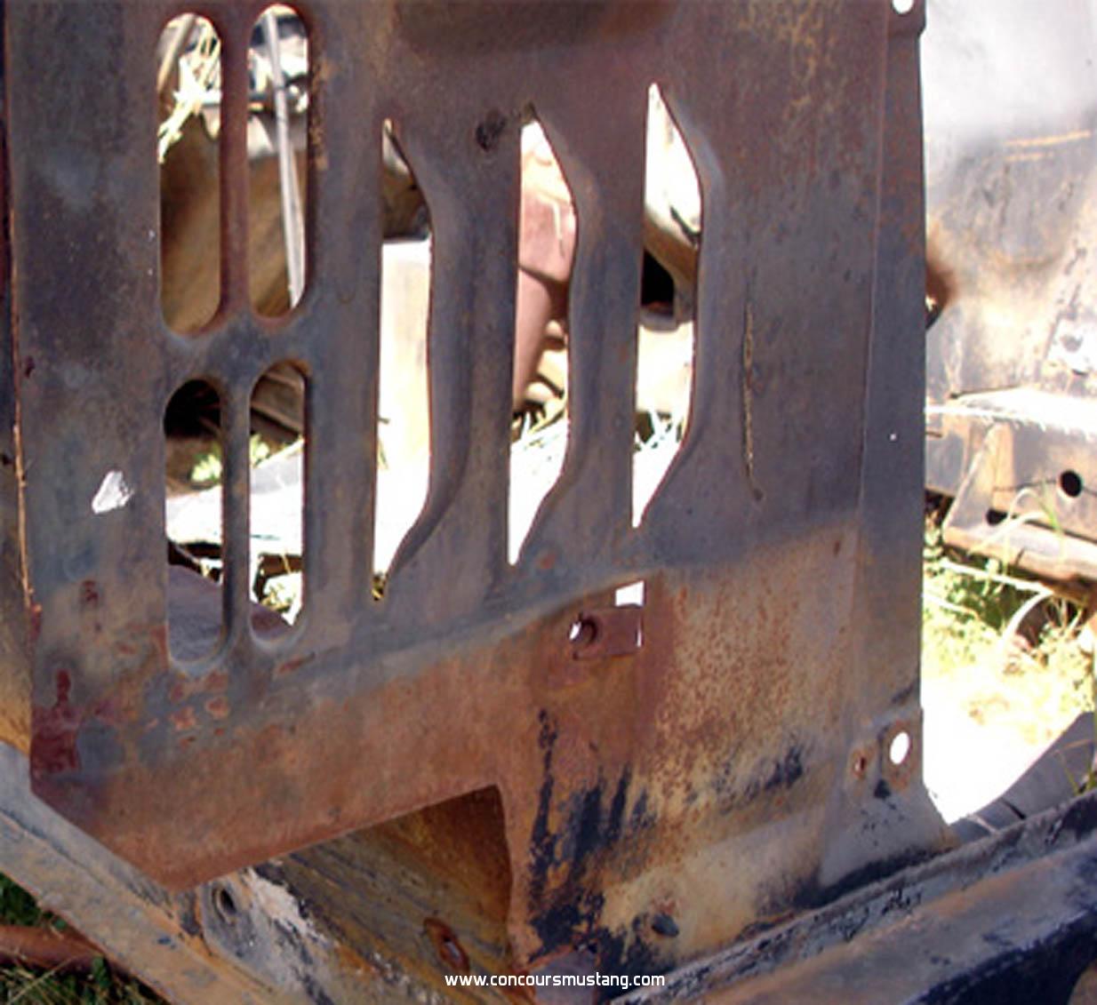

Early style rad support with the vent holes by the battery too

Early style Dearborn would have had the louvers like this
Oval vent holes to the passenger side of the louvers were a design feature through 1965 and 66 (late 66 shown below)

Of course there are no louvers to aid in cooling the generator. Thanks for the correction Jeff. Oops!
