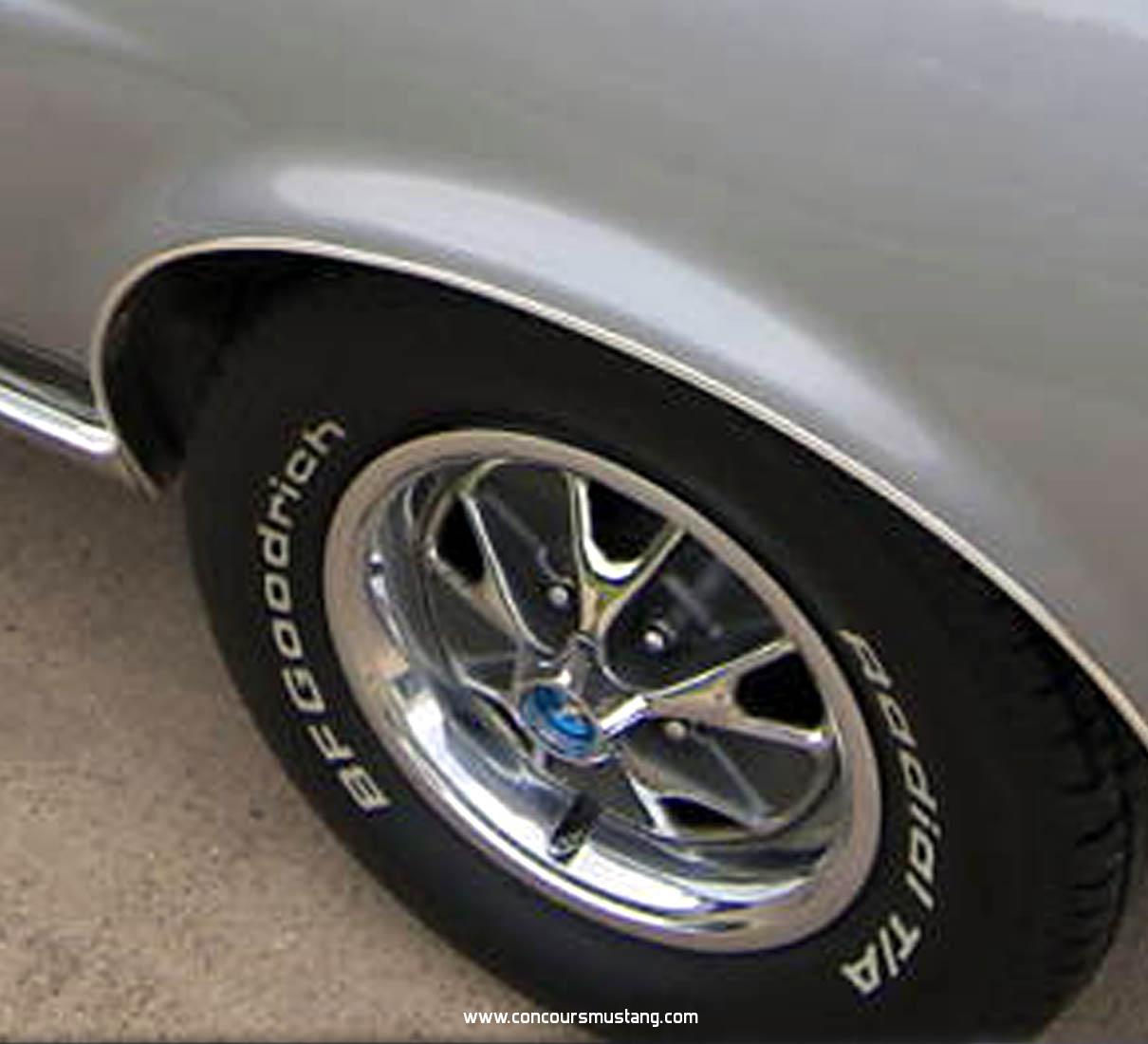

I have a 1967 Mustang Fastback 390 GTA, the Marti Report says it came with 14" Styled Steel Wheels. When I went to purchase them, there were many styles of them. Any help would help. Many options to choose from Like 5.5", 6" wide wheels, Black rims with chrome centers and beauty rings, like in the attached photo. http://www.cjponyparts.com/scott-drake-wheel-14-inch-x-5-5-inch-styled-steel-1967/p/W526-V/

For 1967 I believe that they should be 14 x 5-1/2 wide with beauty rings. The MPC calls out 'painted grey'.

14x5.5, rim painted black, centers around stud holes a charcoal gray. Trim rings (I believe polished and not brushed for 67 but not 100% sure on that detail).  The lower one looks more correct, but can't tell if the centers are black or gray.  Originals of course are riveted not welded ;)

The centers are supposed to have charcoal gray and not the bronze?

    Even though it is a Cougar shop, WCCC(West Coast Classic Cougar) has a lot of info about Mustangs on their website. They show that 1968 is the only year that both Cougar and Mustangs had trim rings with the brushed look(http://www2.cougarpartscatalog.com/c8zz-1210-b.html) on the trim rings, so 67 would be chrome. I actually have 68 Cougar styled steel on my '67 coupe with 68 trim rings and red mustang centers, painted "dark argent" instead of the light argent that is correct for the Cougar. It doesn't look bad to most people, but then they don't know it's not correct.

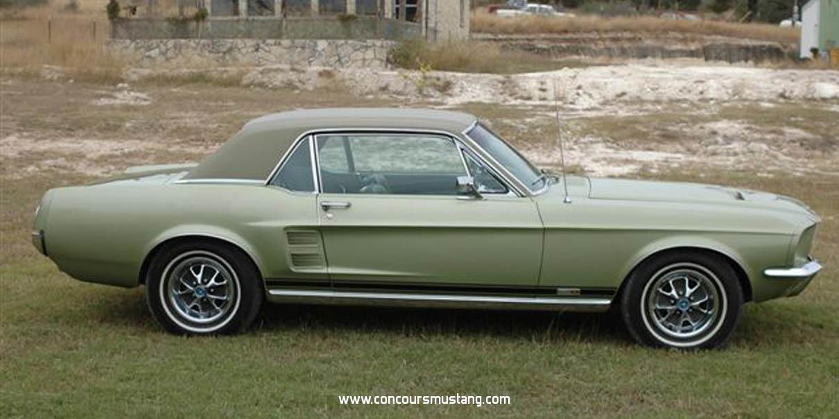

   +1  Here's my 67 coupe with styled steels. 14x5.5, black rim, charcoal gray painted center, blue center caps. Been years since i did this same research but seems to be still correct to this day.  ;)
