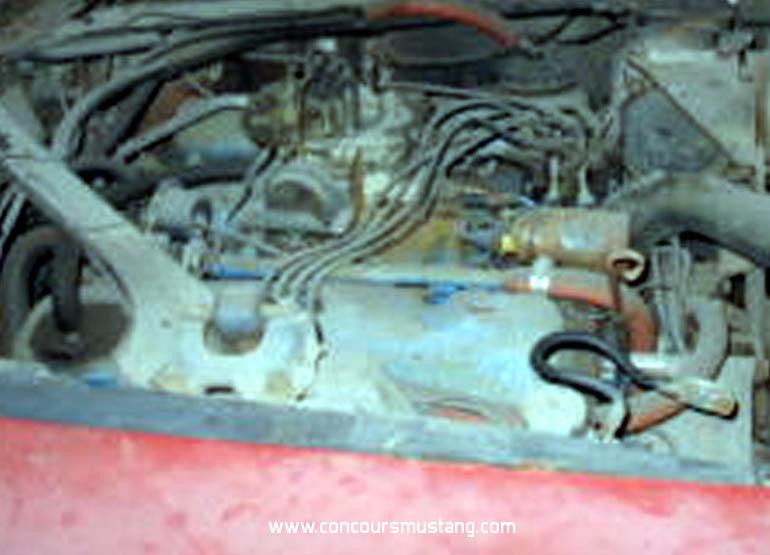

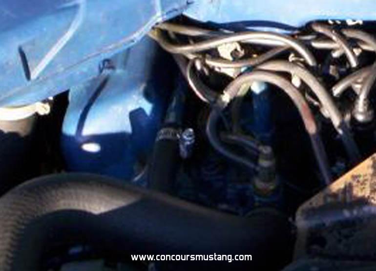

A part that was quickly thrown away first time the heater hoses got replaced or it rusted out. Real hard to get a "good" picture since the air cleaner and other tings get in the way
Couple of examples - early and late. They were used and there
0F05H1118xx
0F03H2004xx
Would guess NOS or good used is going to be your only source
