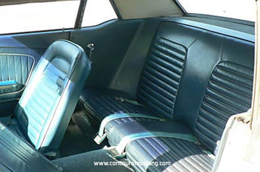

My Oct 64 Fastback has an off white headliner.  I have attached a picture.  What plant was yours built in?

The day night mirror shown in the Oct. '64 built fastback is actually the '66 style with the twist adjuster. The '65 mirror had a toggle, or flipper type switch.
I've noticed that many of these early '65s also had cardboard sun visors.

The day night mirror  shown in the picture (Oct 1964) was first used around February 1965. It isn't unique to 1966 model Mustangs.

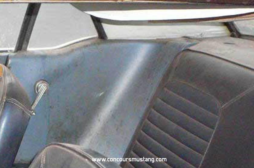

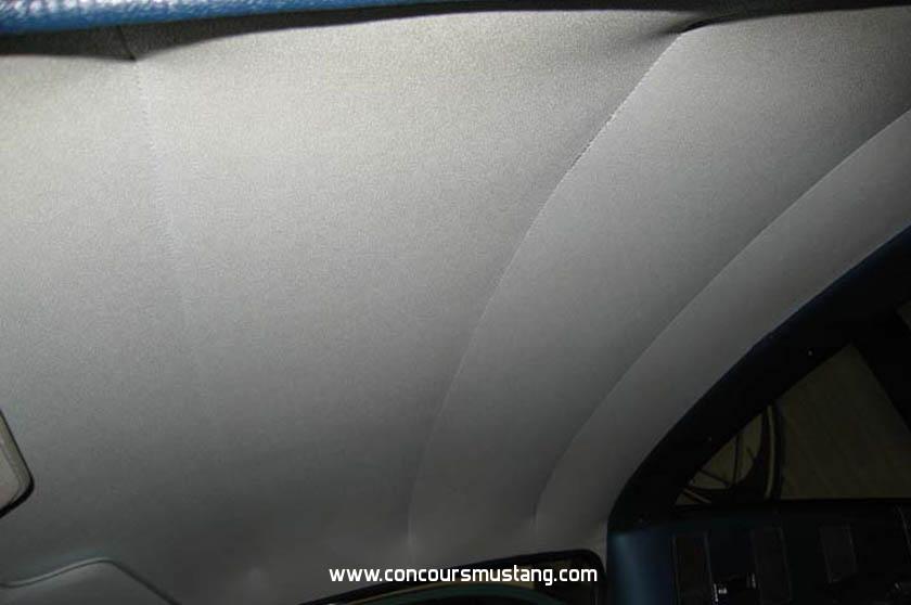

Not the best picture and from a coupe (not sure if that makes any difference from about your time period
Hope it helps in some way
5R07A1301xx - Blue interior
Just for comparison
5R09C170902  headliner
5R07C2039xx  interior with Interior code 22. Digital pictures can be so misleading especially on light colors
