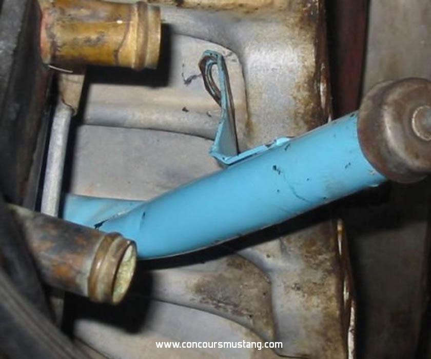

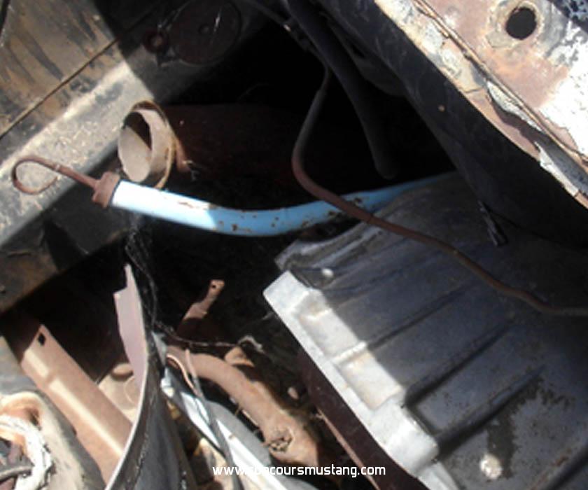

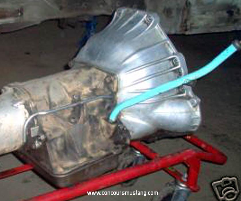

Here you go
Three original examples - all looked robin's egg to me
