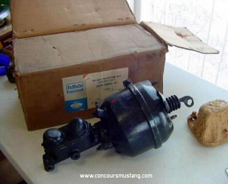

Easy answer (search would turn up a number of threads) Semi-gloss black painted (booster, master cylinder, lid and all, check valve and spacer)
Picture shows the type of booster (supplier) that would have typical on your application. Master cylinder is different from you application though the painting is correct
April booster would have likely been after all the recall issues ;)

By the way, for anyone looking at the picture Jeff posted, the MASTER CYLINDER in Jeff's picture is for a DRUM BRAKE car, this ties to the other previously mentioned thread also on one point.
Jeff : The Kit you have pictured doesn't happen to have any instructions with it, does it ?
Its not a kit but part of a service campaign due to the recalls. The information was outlined in the TSB's Special Service Letter dated March 10, 1967.
More recent information/pictures I found show that one page of information was included in the box with a shipping label attached to it. Not sure of what was on the page but at least some of it was likely how to handle the replacement and return of the old unit.  Earlier campaigns on the same matter included just replacing the check valve. When that didn't fix all of the problems the more expensive kit was sent out as discussed here

Jeff : Thanks, once again for the info. I saw the word "Kit" on the box, and thus the question. I was confused because the "Kit" I mentioned in the other current thread on the hoses, does not list the Master Cylinder as being included. Now it makes sense. I'll check my TSB's to see if they might provide any answers on the hoses.
What is the Part No. on that Recall Kit ?  The photo came in a little blurry and I can't make it out.
Can't make it out either (only have that one picture) For others notice the label design, this is typical for boxes containing parts in response to a service campaign (recall) during this period
Did find a reference and really poor picture on the internet of a page/instructions in the "kit" could not make out the words but it appeared to be more like instructions about the service campaign and how to return the old unit (had a preprinted shipping label attached) than anything else
