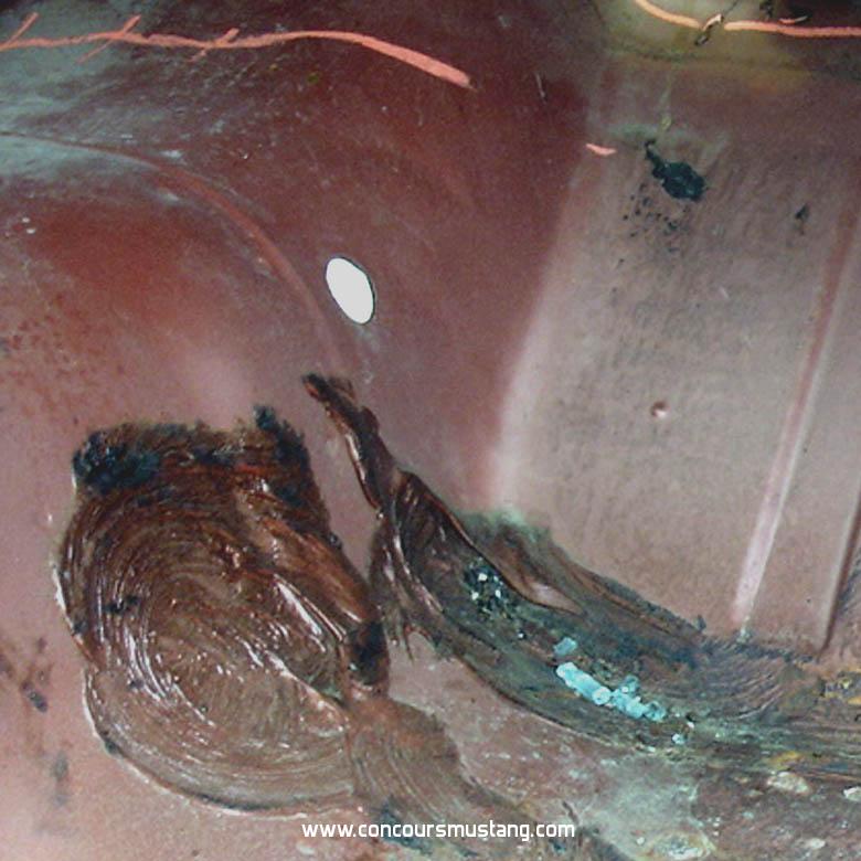

Anyone have a picture handy of a factory-made hole that the A/C unit drain hole goes through?  Looking for approximate location.  Evidently, early cars did not have the dimple like later.

Crappy photo, but you can see the hole.  9/65 scheduled build San Jose car if you care.

Is the hole size supposed to be 1 inch?  I would love to see pics of the A/C unit in place showing the hose w/o cover and w/cover.  Also does anyone have a pic of what the hose looks like protruding from the underside?  Thanks for all the help!

Yes, hole size should be 1".
