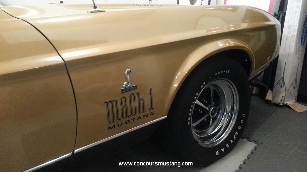

I purchased a '72 Mach 1 Q Code that has Cobra badges above the Mach 1 decal.  Is this correct?  I can't find any photos online with these Cobra badges.  I want to make sure these are correct or if someone added them.  Thanks.

Looks like the 1968 Shelby emblem reproduced by Scott Drake.

I purchased a '72 Mach 1 Q Code that has Cobra badges above the Mach 1 decal.  Is this correct? ......
Not original - a PO add on
May be able to pull some dental floss behind the adhesive (between it and the paint) and remove them without damage. Might need to clean up the remains with a little reducer and some polish

Thanks guys.  I'm certainly no Mustang expert, but I thought those badges were out of place.  The car has been repainted at some point and still needs a few things patched up here and there, but overall looks and runs strong.  I'm researching the original purchaser of the car and hope to find more info, pics, etc.  I'm the 4th owner.  More to come..  By the way, this forum is amazing.  Thanks to all for this amazing resource.   :D

Agree with others that the badge is not original and should be adhesive backed for removal.  Car does look nice.

Great factoid on the Shelby's, midlife.  I've tried the dental floss method, but it's too weak.  Those badges are on there!!  Gonna try fishing line.  Don't want to damage the paint.
