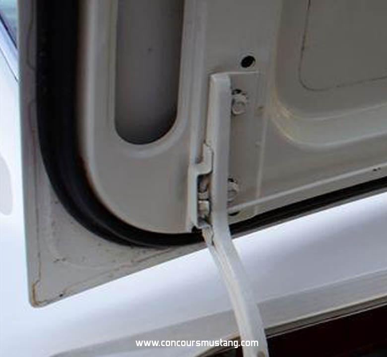

I have a 1965 Dearborn built Fastback with an approximate build date of September 2, 1964.  I'm having a problem where I install the trunk lid torsion bar with the original retaining clip and the retaining clip pops off unleashing the torsion bar from the hinge.  Could the original retaining clip be tired?  I don't know.  I'd like to keep the installation as it was from the factory but the retaining clip is not reproduced.  I searched the forum and came up with mixed results.  People have implemented various solutions that worked such as putting treads on the end of the torsion rod and installing 2 bolts, getting 2 non-concours retaining clips from the auto parts store and doubling them up and even drilling a small hole in the end of the torsion rod and installing a washer with a cotter pin (Maybe a dealer fix?).  Any suggestions on how to remedy this problem and keep it as close to factory as possible?  Here's a couple of pictures.  Not the best but better than nothing.  The white stuff on the end of the torsion rod is grease.

With the trunk lid on, the torsion rod was successfully installed.  When I close the trunk lid, bammo!  The retainer washer on the end of the torsion rod comes off and the torsion rod pops out of the passenger side hinge.  The arm on the passenger side hinge that the torsion rod fits into has side ways movement when closing the trunk lid.  Is this normal or could the hinge be worn out?  The hinges in general seem to have a lot of play in them but I don't know if this is causing my problem.

How much "side play" is there on the small short arm that connects the rod to the hinge?
If that end of the arm/bar is worn or the rivet is not tight it will allow side play and put additional pressure on the end clip (on the torsion bar)  and pop it off. Add this problem to an old worn retaining clip on the end of the bar - BAMM  :(  ......... Seen it before
There is about 1/8 to 1/4 inch play on the short arm and the clip was removed before so as you said the clip is probay worn out since the trunk worked fine before I took it apart.  I'll have to see if I can find a suitable replacement clip untill the part is reproduced of I find a good used one.

Here are three pictures of a Sept 11, 64 San Jose build Fastback trunk torsion rod. To install, the rod was "hooked" into the RH trunk hinge and slid into the slot in the LH trunk hinge up to the bracket. Note the clip. It looks like the clip used to hold the AT cooling lines together. At the same time as the rod is slid into the LH slot, the RH end is slid into the swinging arm. It is held in place by a 1/4 inch id washer and a cotter pin.

Here are three pictures of a Sept 11, 64 San Jose build Fastback trunk torsion rod. To install, the rod was "hooked" into the RH trunk hinge and slid into the slot in the LH trunk hinge up to the bracket. ...........
Yes think that was the last month they used that configuration at San Jose (very short period)
Looking at my pictures I see that Dearborn was using that configuration (with the electrical clip inserted on the drivers side loop in the rod) in August 64
