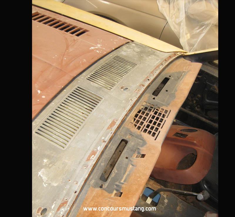

Using that sequence, this picture shows a number of different paint processes and colors:
Red oxide on the top of the dash, followed by a light dusting of gray body primer/sealer.
A mask appears to be used to shield the dash top during the front of the dash's paint job -- the breakover to the left of the eyebrow has a hazy line indicating something was keeping the dash color paint below here.
Later a different mask is used as indicated by the Line Gold paint. This mask had to shield the entire dash during color coat.

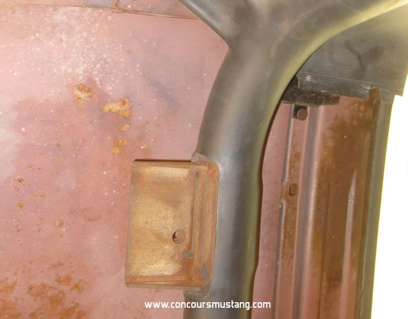

It can also be seen here that although the 65/6 cars required paint on the A-pillers as they were visible and not covered, the 67/8s had a cover, so this was no longer required. Was it always done? Jeff shows it was in certain pictures. But mine:
has only some red oxide followed by a light coat of primer/sealer with a small amount of Lime Gold at the base.

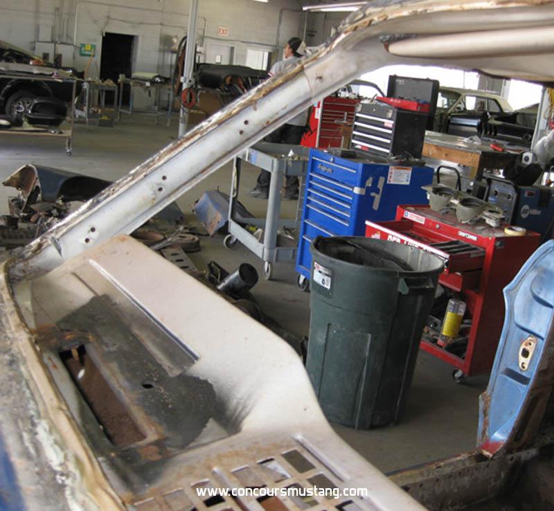

Dash & A Pillar area with defroster black out

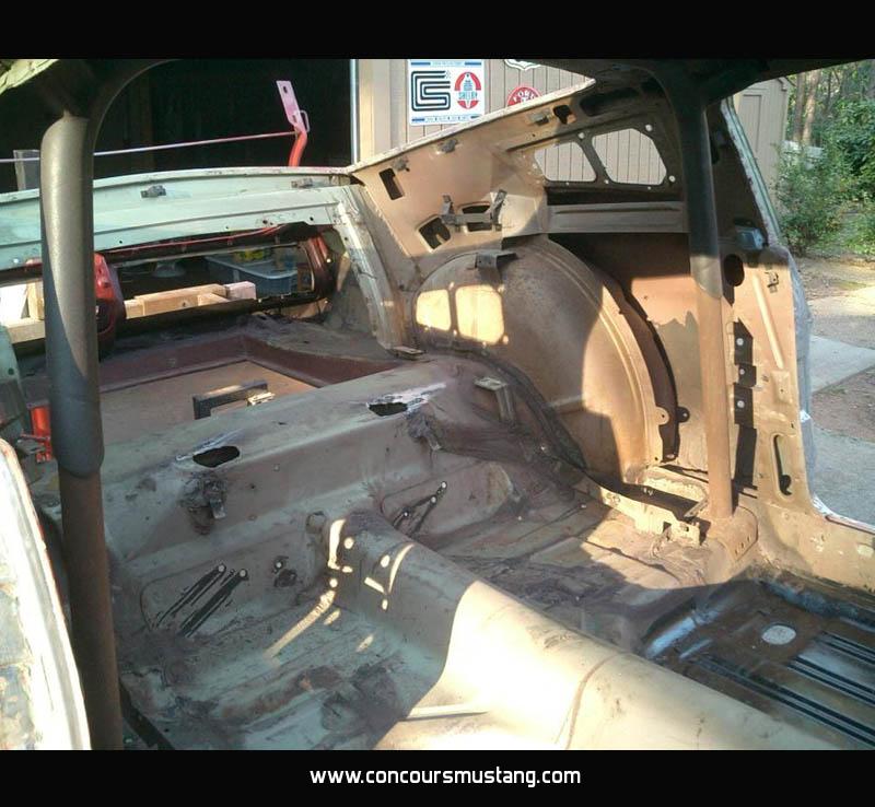

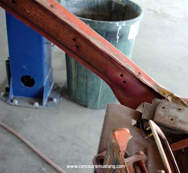

Roof example - pretty much red oxide

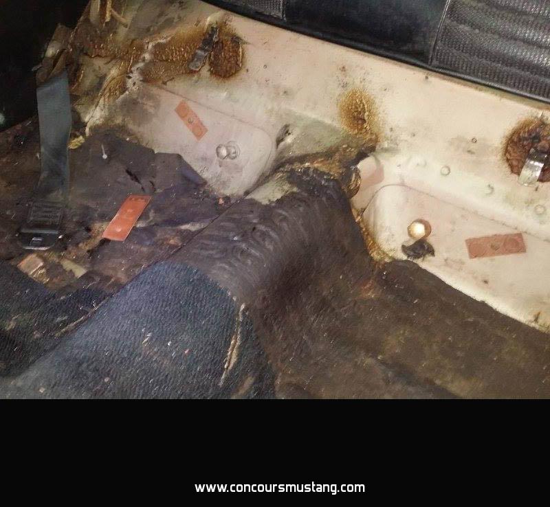

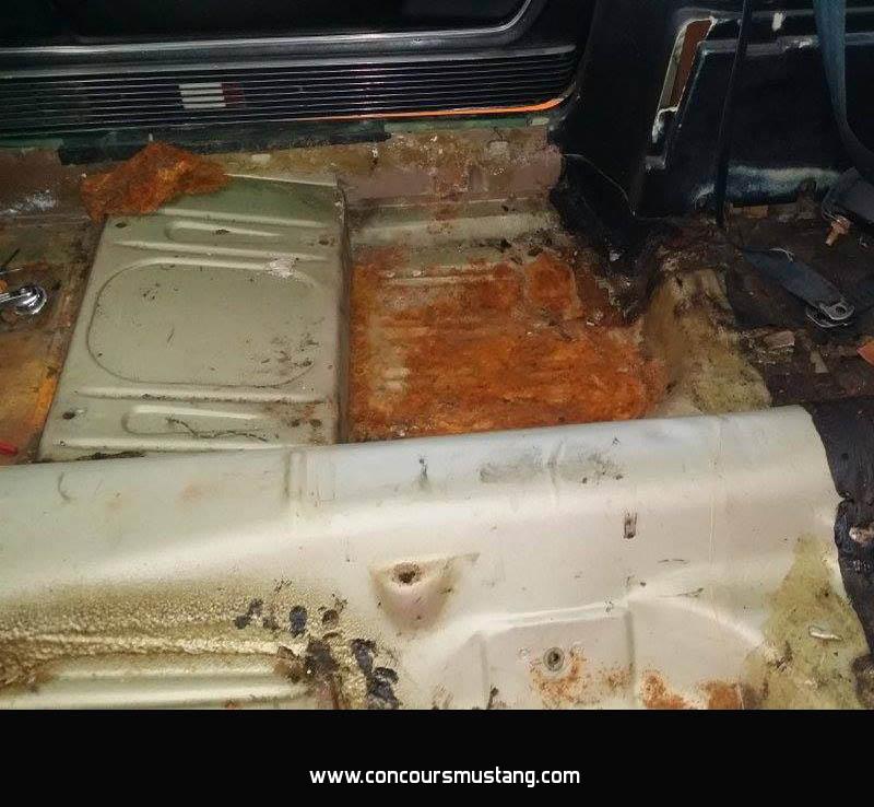

Floor examples Strong body color typically since all the heavy overspray and paint would float and settle downward. Less as we get away from large openings and direction of application

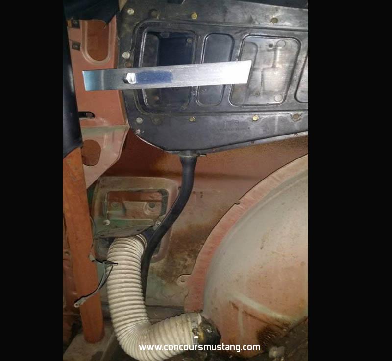

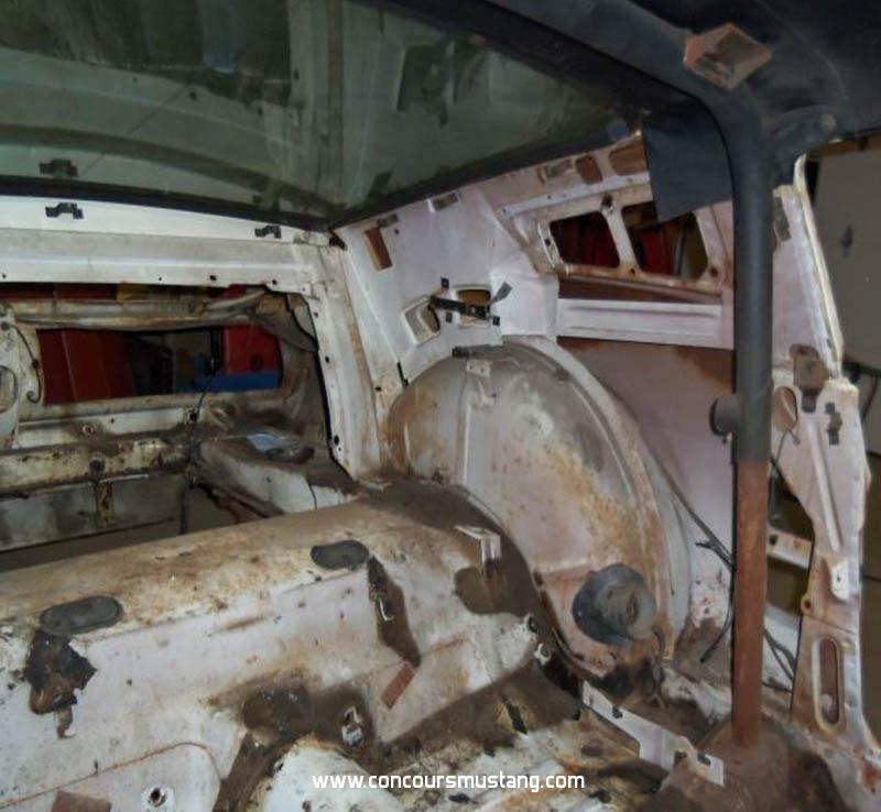

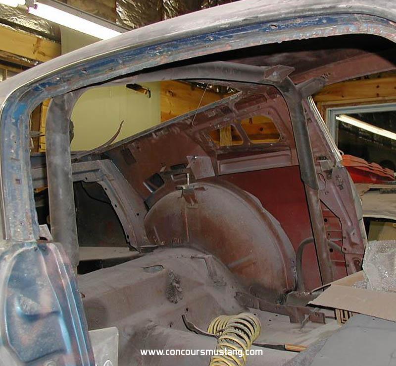

Rear section of the interior fastback

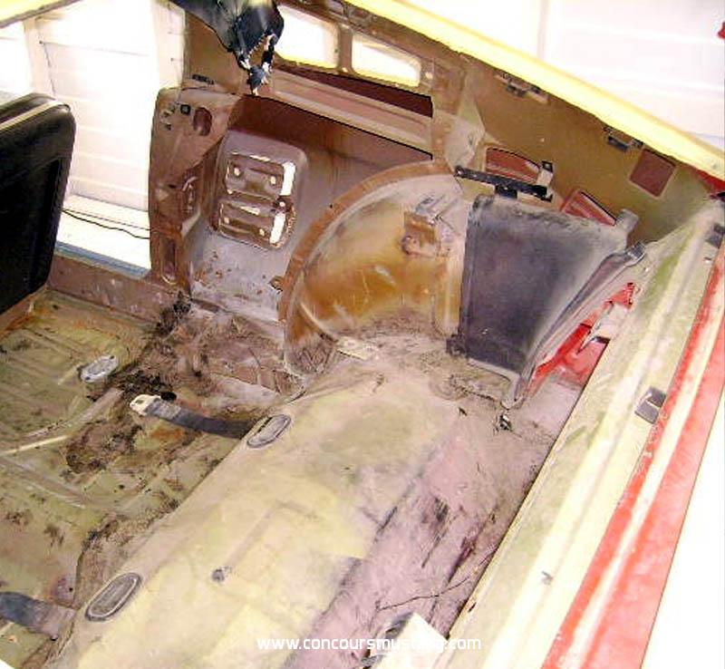

Remember these are used cars and some of the itmes may have replaced or repaired over time. Focus on the subject they were posted for
Quarter panel has been replaced

Those pictures sure run the scale from some paint to lots of paint.
The first picture after the heading Floor examples looks very much like a picture I have of this area from the PO of my car.
I also appreciate you drilling in on Shelbys.
The side vent area and the entire trap door area pics were especially useful.
The second to last picture of the white Shelby is what most closely approximates areas where I've sanded through the paint. It was hard to picture just how things faded in and out. I've got it now.
I'll try not to replicate the dryer vent hose on my rear brakes, however.
