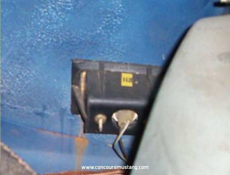

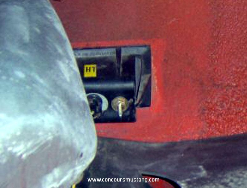

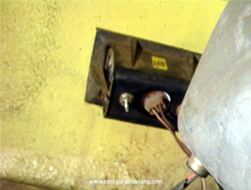

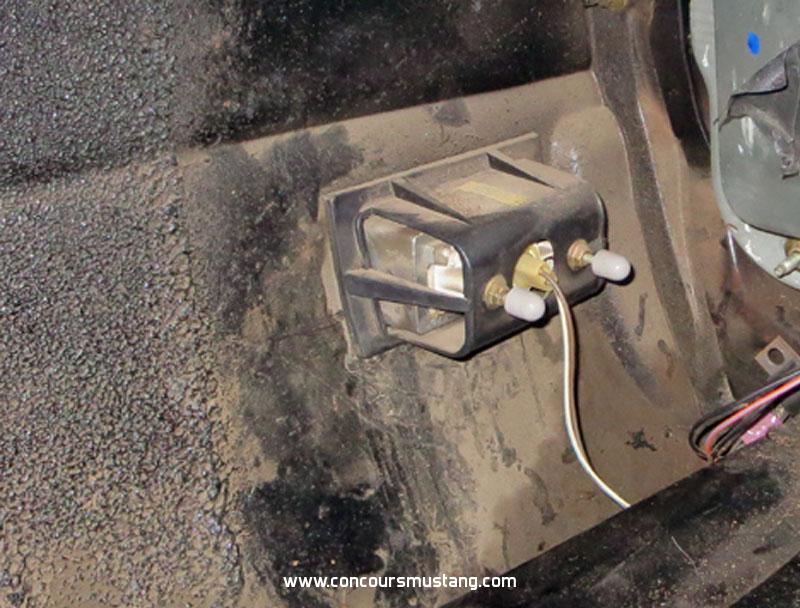

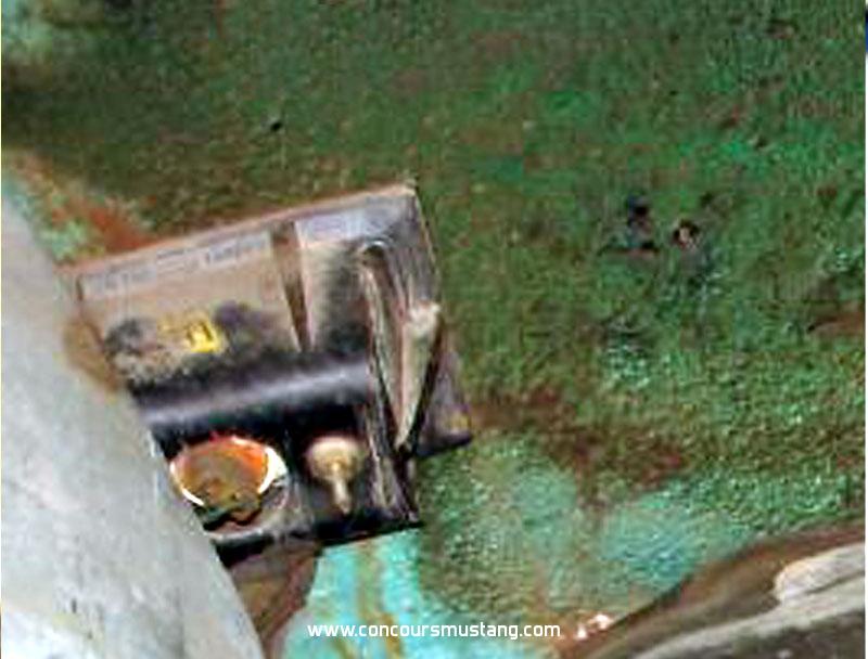

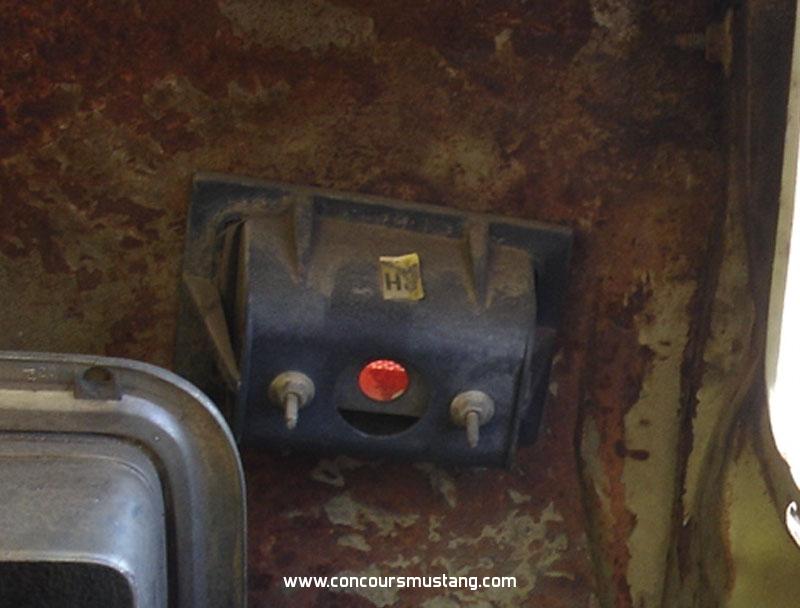

You didn't include when and where your car was built so we're left to guess. Picked a collection across the plants and months.
Not sure what metal bracket your referring to or what your have since you didn't provide a pictures. Hope one of the following helps you in your search ++
0F100xxx
0F123xxx
0F166xxx
0T1138xx
0T145xx
0R1xxxx
Stud/ lugage protectors fell off of allot of them :)
Re: 70 rear side marker lights
« Reply #2 on: February 06, 2019, 12:33:55 AM »
Yup, the pictures reflect what is in the 1970 Mustang Electrical Assembly Manual (AM0033 pg 41) right on down to the stud protectors.

There is a metal strap on white plastic just under the black plastic outer holder on the later 70 wire  black plug push-in type socket VS early type white twist in type wire socket.  I think the black socket type shows up after jan 70 & uses the  wide black tape covering the socket or is that a plant change. Look at jeffs last photo as u can see the silver metal strap under the black plastic & where the tape was before being peeled off.

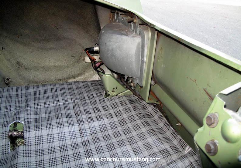

Thanks, that looks more familiar to me, since my car is a Dearborn ,April 21, 1969.
My friends' Metuchen 1970 Boss 302, has them however. In this picture we can see the part number, DOZB-15A439A.
