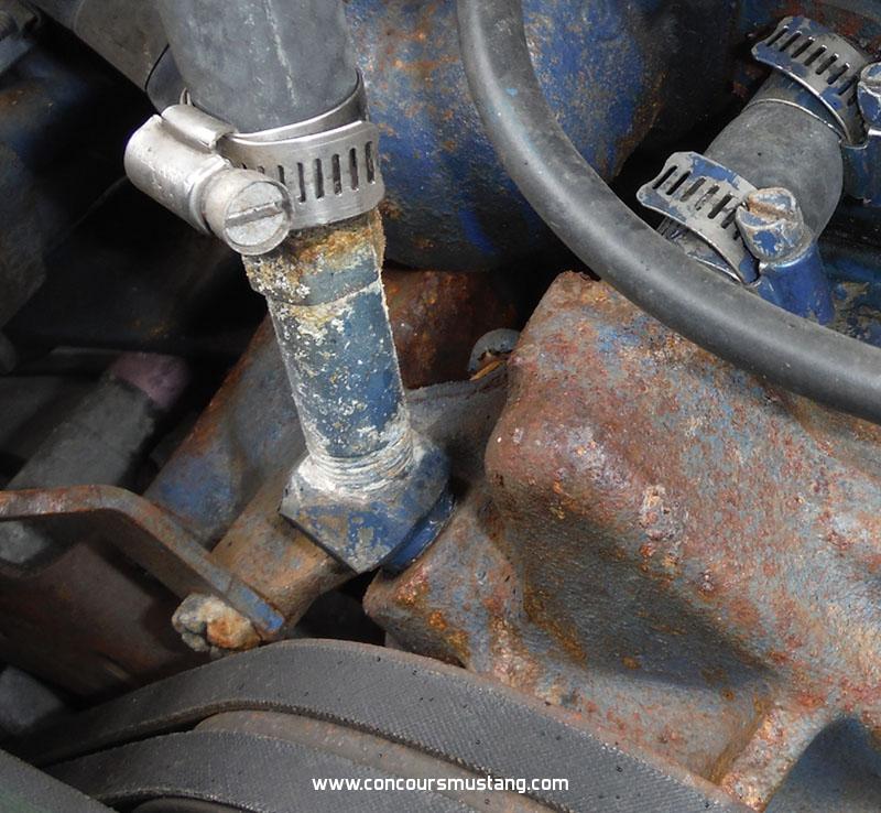

The green NJ example has had the water pump fitting replaced likely due to rusting out. The one in the first (67 SJ) example with the odd fitting then the add on straight section is the original and discussed later in the green NJ examples thread.
Close up. Obvious to see someone in the past was in the area of the fitting with a rattle can so we don't know if the fitting was painted with the engine by using this one example

 Thanks. Judging from all the blue paint and other areas it doesn’t belong I’m gonna say the painting of the nipple is suspect

Looking at everything that is the correct/original fitting and it was added after (for some unknown reason) after the engine was painted. Haven't found any signs of them using a slip over mask like other applciations or parts

Picture of the item Bob is referring to in his post above. Same as posted  (now that these are merged) above
Plenty of evidence that it, along with other parts in the picture, got a coat of paint during a rattle can refreshing by a PO
Angle of the available picture does not show the angle fitting very well.  Radiator and such got in the way
