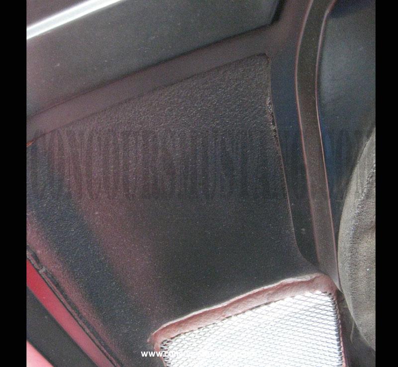

Focus begins with details about the texture of the bottom side of the hoods top panel and her is a picture from that thread
That would be Great, if you could. Really want to know more about what makes the texture under this hood and also how do the pros replicate this texture today.

jeffs photo ec2-3 looks correct and original just dont  sand off the textured areas  on bottom side of hood .

Not sure what product is available and being use today. Been a while since I had a local sop apply a product. They use the same product to produce the texture on the taillight panel outer surface and end caps on another 69 we were helping out.
A few more pictures of the texture

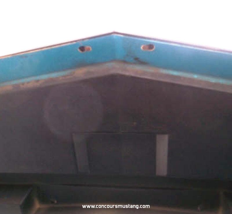

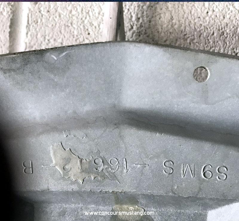

Another detail is the number in the lower reinforcement panel right behind/below when hood is open, front lip. This is sometimes sanded off or removed if the hood bottom has been sanded or repair has taken place.  Very early cars typically don't have this in the mold process for some reason  - Bottom picture though its not really clear
Very early example (picture provided by Armond - Thanks)
Typical/vast majority- Orientated as it would appear on the bottom of the hood when open. Can't say the glob of resin is typical so please don't copy that detail  ;)

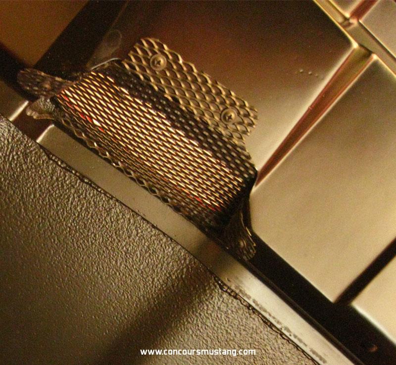

Don't know which picture or detail your looking for. Are you referring to the one we removed since it was from a 69 (in a 70 picture thread) or another.
Yes, that's the one. The one showing the black paint around the perimeter of the hood spoop grate.
Many thanks.

Anybody know what product was used to glue in the  black rear scoop screens like in top photo as i am wondering if that brownish red sealant was same as what held in the 68 KR ram air chamber ?
It would be logical to assume it was the same given the same AO Smith doing the install and just one year different. I haven't always seen it the same color however for the 69/70 cars so maybe more then one different products used. Have seen some with what appears to be a dark gray on unrestored cars. I am sorry to say I haven't kept track of vins on the different cars to correlate a pattern if any.

Maybe one can do a good job of replicating a similar texture pattern to the original later tailight grained pattern and end caps using spray on products however the originals(majority of 69/70 production) had the grain pattern pressed into the mold and not a spray on texture. The very early 69 taillight panels that did have a spray on texture did not look anything like the under hood . They were more of the spatter type texture similar to the texture on the 69/70 trunk mats.

I thought I would mention that the 3/8 hex head sheet metal screws are a little out of the ordinary when used to secure the hood screens. I would not copy that detail . If you have pictures to show context like the series being presented here for your specific car showing the anomaly is one thing. I can only guess that maybe a mistake occurred where the smaller screw would not tighten up because the hole was too big and so AO Smith used another larger screw. (about 3 times bigger in this case).  The more typical hardware is the small pan head Phillips with washer surround which is also used to secure the rear taillight panel .
