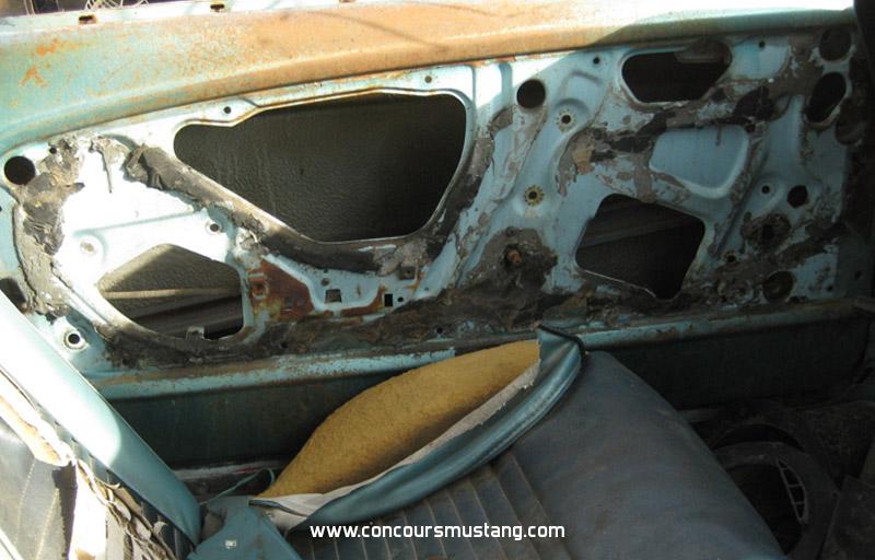

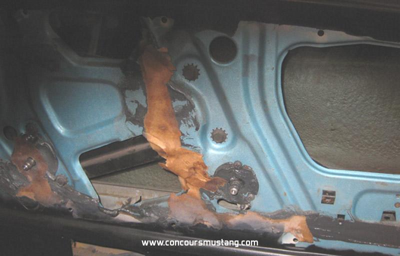

Also did the factory use all of that dum/dum sealer inside the door or was it done by whoever restored the car. There are literally pounds of it on the door panels.
There is normally a pass of the sound deadener wand onto the inside surface of the door skin. Not sure where you found the "dum-dum" there is the dark gray stuff on the surface of the interior side of the door that sealed the weather shield to the door you can see in your lower picture

The dum dum (or other butyl like substance) I am referring to is on the outer/inner door panel between the vinyl/cardboard door cover. There is a lot of it as if used to bond the outer door panel cover to the metal interior panel. You can see what I am referring to in this photo in the upper left hand corner

that 'dum-dum' was used to install the watershields under the door panel.

The sealer was used liberally behind the paper, water shield

Got it. Thanks. Did the factory use that much? Just trying to establish if the amount that was on my door was done in the factory or after the fact for reference
Sometimes when you remove it more comes off with the weather shield while others times more stays on the door surface so comparison is difficult
Depends on the worker that applied it to the surfaces also. enough to do the job or just plaster it everywhere. What is visible (left on door surface) does nto indicate all of the product originally used
67 San Jose examples also since they are the same/similar
