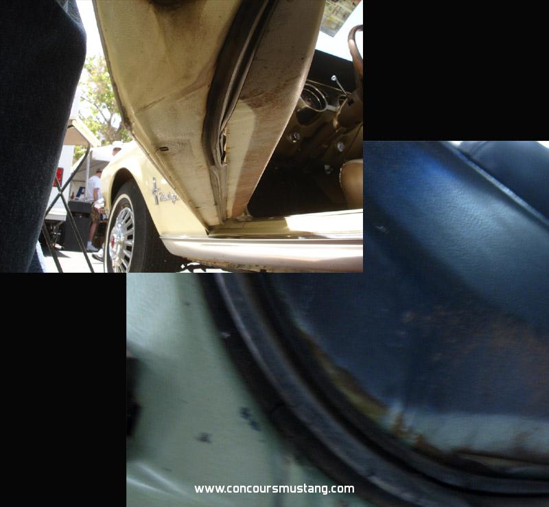

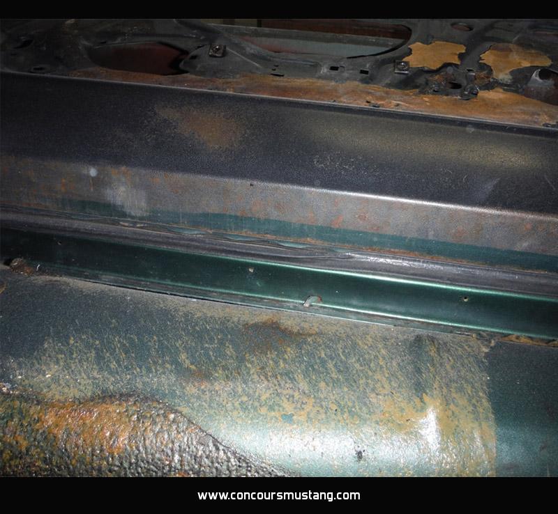

Guess we've not posted before the lower door finish for a 68 San Jose though typically they are the same as 67 as shown in those threads and the undercarriage restoration article
As Marty reported like the other interior panels (including doors since they were attached to the car) the interior was painted with color first then those surfaces were masked. Often the paint on the bottom of the door was light and showed poor coverage - bare metal in a fair number of examples.
Some original examples Tried to get at least one that represents your cars coloring :) Good to have a fair number of pictures to choose from
Much more body color in the proper areas than interior color on the bottom of this one. Note no primer was applied
Some times (not usually) the masking edge reached out to just short of the weather strip retainer (inside edge) and sometimes it was further away that the top picture shows.
The Dark Charcoal metallic application is discussed in more than a dozen threads. Most of us use a couple of light full coats of your choice of semi-gloss black over freshly stripped metal (some like a little primer) followed by a couple of light - on the dry side- over coats of the Charcoal . It can be a little transparent (read allot of clear) Too much paint and you'll fill the grain and leave the finish glossy
Last I used I got from Auto Color Library Got the PPG that was available at that time. Before that I got PPG Lacquer but had to go across sate lines for that
