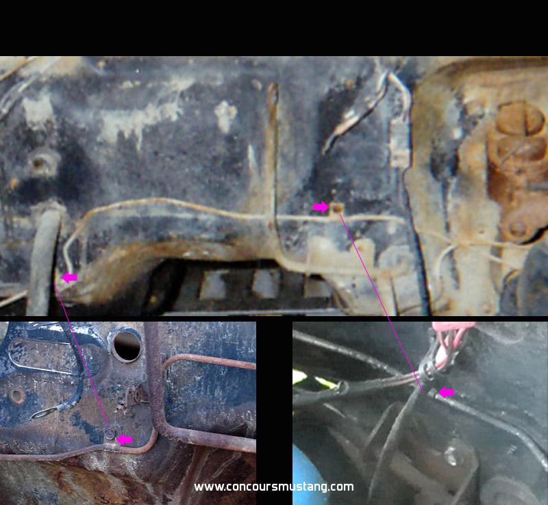

BEFORE Restoration shots (San Jose example):
These pictures were taken in very poor lighting so I adjusted the filters to help you identify the mounting points and routing easier.

Thank you for those pictures! They help a lot!
So it looks like there are 3 clips on the firewall on the line from the distribution block to the passenger side caliper?

« Reply #4 on: December 25, 2020, 03:31:42 PM »
Negative.
I see only 2 plus one for the fuel line.

« Reply #5 on: December 25, 2020, 03:41:17 PM »
It looks like there is one under the heater hoses, one above the accelerator bell crank, and one below the brake booster in this photo. I could be wrong though about the one under the booster. Hard for me to tell...

« Reply #7 on: December 25, 2020, 08:54:04 PM »
There isn't one under the brake booster. Look at picture 1 for another angle.
Only see two on the passenger side line on the early 67 NJ examples I have pictures of. There is one to the inside of the steering column for the rear brake line that you might be seeing
Also believe there is a clip that holds both lines together/apart just inside the steering column location also. Its the one made of spring steel and shaped like a "3"
