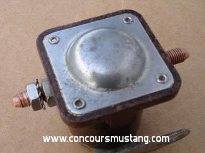

Here is an original (black body BTW), and I have a picture of this side by side with a new repro somewhere and they are certainly different.  I would love to find one of these NOS as well - good luck with your search!

Black body for your car.
Haven't looked at repos to compare - normally just get an original. Believe some had figured out (purchased a rivet tool) how to remove and replace the large center rivet, so that the mount could be removed and replated. Normally all the is visually poor on originals

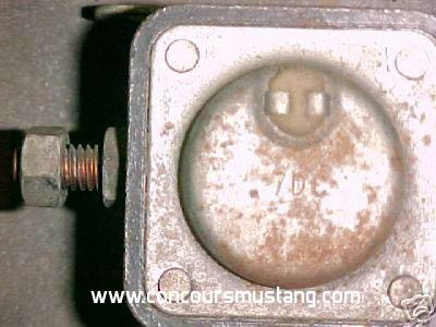

As far as texture of the surface on some of the brown and early black ones the individual fibers can be felt with a finger on others they are very smooth. Miht be a different vendor, batch of material or other production difference
Here is a shot of an early brown style bottom and a 66 - up with the vent and felt filter

Great pics!  I don't have felt at the bottom of mine here are a few pics...Not sure if this is a  early or late one, it has brown flakes (bumpy, looks like rust) around it but was originally black
Whats the best way to clean it up? Does anyone restore these?
