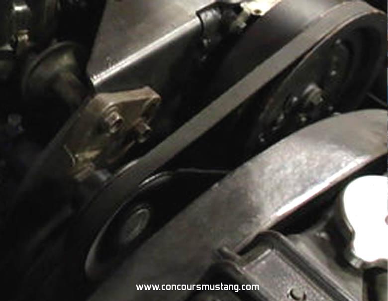

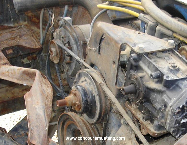

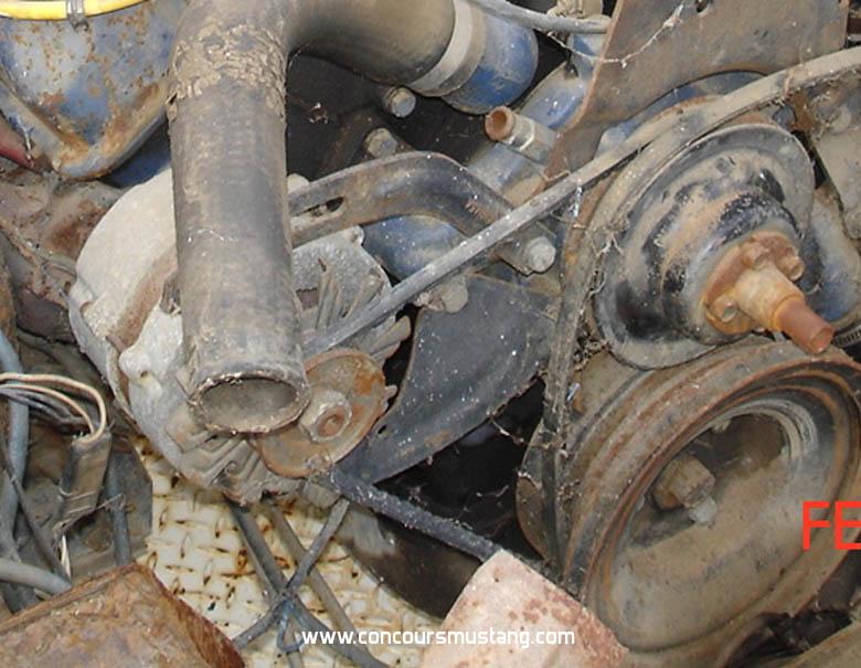

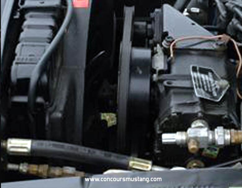

« Reply #8 on: December 17, 2015, 08:45:55 PM »
As for pictures I think this is one of those times were an Assembly Manual would be well worth getting. It will have all the fan belt routing, hardware and brackets shown in exploded views
Below at some pictures of course each example has been modified or maintained through the years so don't assume anything is factory correct by itself. Check or ask to confirm ;)
Hope these helps
