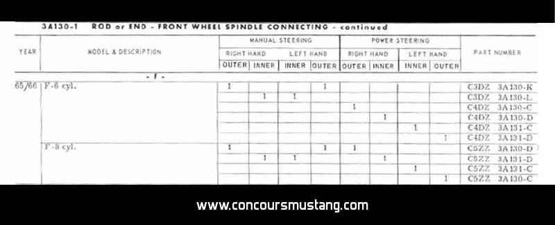

  These tie rods were very common, as I understand all V8s shared the same tie rods depending upon if they were manual steering vs power steering.
The 65-66 V8 tie rods are not all interchangeable between PS and manual steering cars.
Maybe this scan will help illustrate (taken from a final printing of the MPC)  the different application and parts.  There was a campaign/recall related to tie rod ends at least for the PS cars in 66  if I recall the date correctly. Have not be able to figure out or find documentation of the problem or issue but have a campaign "kit"  of all four in a single box with the campaign label on the main box
