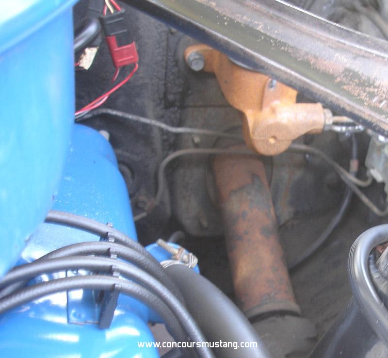

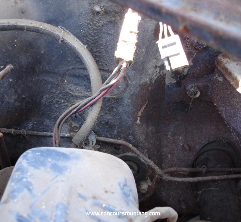

A couple of the over the steering column (early) routing and close to the change over period
7R01C16808x Looks like the upper line may have been caught on something and slightly bent at some point
7R02C16488x

Good enough. My original lines were bent some over the top of the column and the new "Right Stuff" brand isn't exactly the same on some of these bends so I am trying to work with these new lines and I had only mine as a guide and could see an issue. These pictures you (Jeff) and Bill shared, do the trick. I am putting some wide painters tape down around the originals (once straightened), scribing their original paths and then I'll fit the new ones in to match.
Amazing how close these two lines looks to come to the column (like rubbing the column on some examples). It looks like it would be wise to have the column installed first and then mask over the interior color paint to avoid scratching it while I install the new brake tubing.
