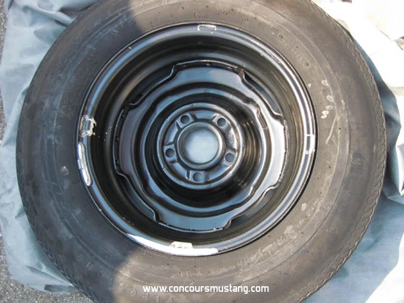

A similar car can be viewed in the Jan? 68 San Jose C code bench seat coupe - Unrestored Picture Thread located in the Unrestored picture section of the site. Though the buyer of that car originally got the hubcaps changed at the dealership before they purchased the car so you end up with body color wheels with full wheel covers. A picture of the spare is shown below
As discussed in the other thread the small diameter "dog dish" hub caps would be what it arrived with. Often in the trunk of the car for transport
