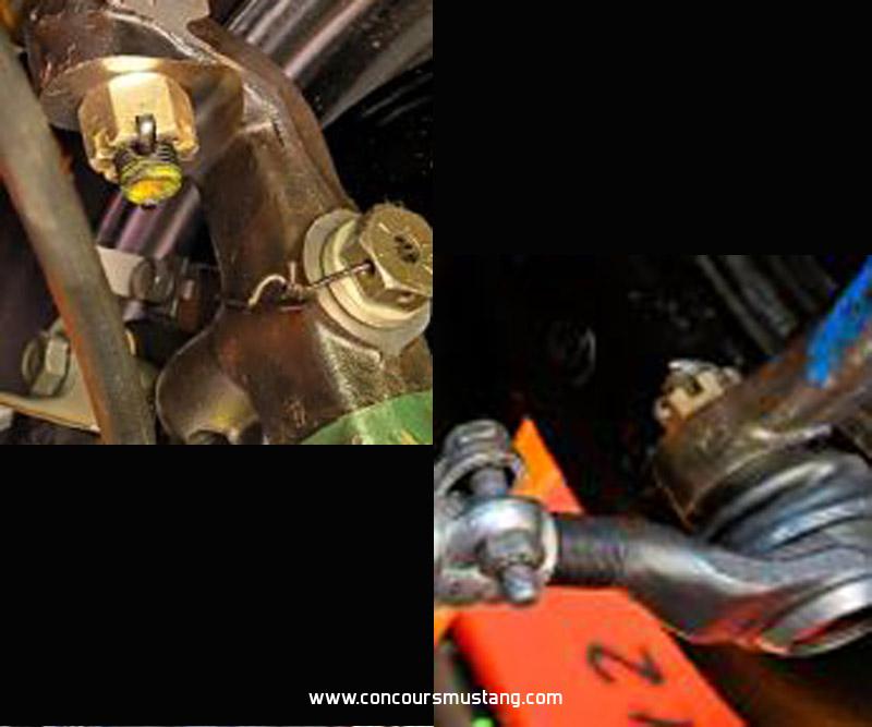

« Reply #3 on: November 28, 2023, 12:33:51 AM »
Only came up with examples that were clear for Dearborn examples. Given how close and because they often shared the same suppliers for other parts I think they would be the same
On used or aged originals it appears that they were likely zinc but we know that dichromate doesn't hold up well over time and I think they were zinc dichromate. Sure if that statement is incorrect someone will offer that opinion.
Examples from two different cars.
Three examples from another car
And finally examples from a very low mileage (just over a thousand miles reported) example

« Reply #4 on: November 28, 2023, 01:27:47 AM »
Hope these help
To others who are not aware zinc dichromate (gold) is a protective process that goes over the zinc silver. The zinc dichromate has to have the zinc silver to stick to. As the zinc dichromate wears off only the zinc silver is left.

Excellent. As ever, thanks so much Jeff. As an aside I notice it also looks like the bolts which secure the brake caliper to the spindle are also zinc dichromate  - I didn?t know that
Not Jeff but I think that you are being tricked by the lighting in the picture. The caliper to spindle bolts are typically zinc phosphate.
Think boss167961 you looking only at the last set of pictures and agree its a lighting issue from a second source so the angle changes the "look" Check out the middle group of pictures to see a better representation of the original find that matches the phosphate and oil finish. Also, general comment, try and find multiple examples to confirm details since there are times where a very nice or low mileage example has been "helped" by current or past owners to make them a little  ::) more presentable
