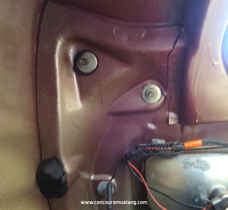

Because the end caps were placed on the unibody during the paint process the studs exposed in the trunk were painted when the painter applied paint in those areas, if and when they did. When the nut and washer combination were installed this compressed the sealant and removed the paint from the threads of the mounting studs leaving them with body color on the tips only as shown below in the pictures.
As the nuts and washers were tightened with power tools applying a consistent amount of pressure often the sealant squeezed out in a somewhat uniform way creating a thin tube-like structure as seem below.
I've posted some examples from around the time period (not real close this time but representations of the practices of the time and plant
No paint on the studs since too light of paint application in the area (very little to none on the panel in that area

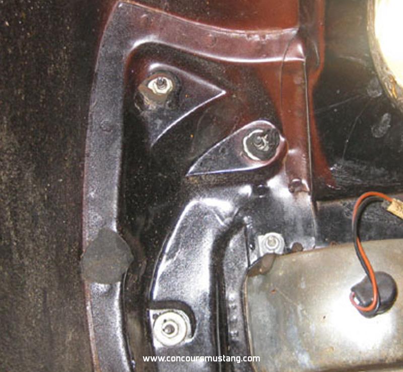

Paint on the tips here  - lot more paint in the area
Mix in the area - Not easy to see

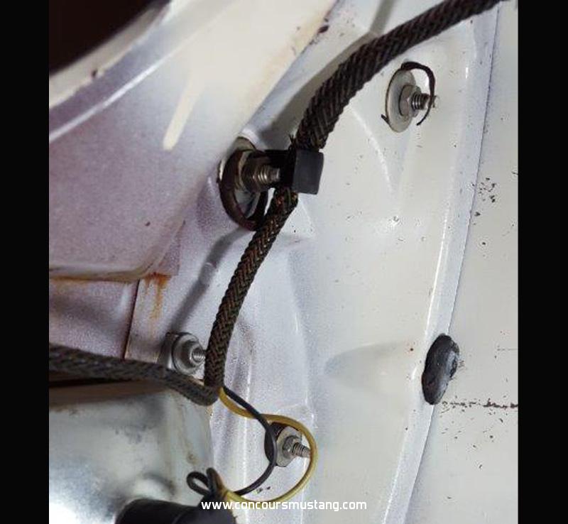

Painted tips
If it were mine I would do the painted tip in areas where there was paint on the interior of the trunk around the attachment point
