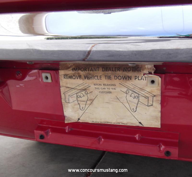

  Do I put the the tie-down sticker on the backside of the license plate or behind the plate on the valence?
On the valance behind where the plate would go

Do you have a pic of the sticker behind the valence? Seems like the sticker i have is too big. I would have to put it over the valence screws and a little lip on the bottom.

They don't "fit " and were designed not to last too long - and because of this once exposed at a yard notmally don't last a week
Here are two examples from 66 I had handy- normally they lap over on the lower lic plate bracket (not always pressed nice and smooth but bridged across) or higher on the valance '
