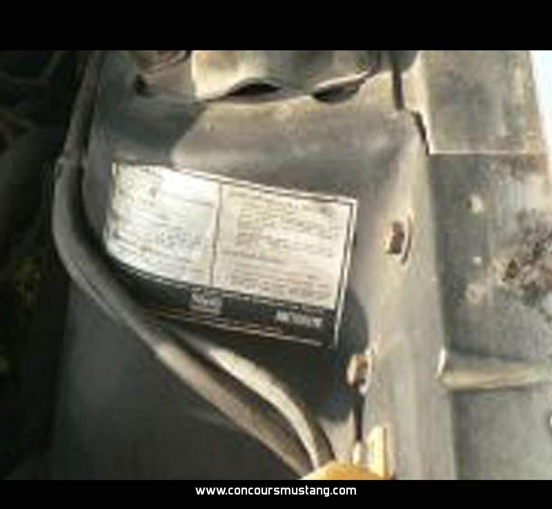

-Service specification decal (DEC052) - Drivers side shock tower. May be at the location in the picture or approx 6 inches below

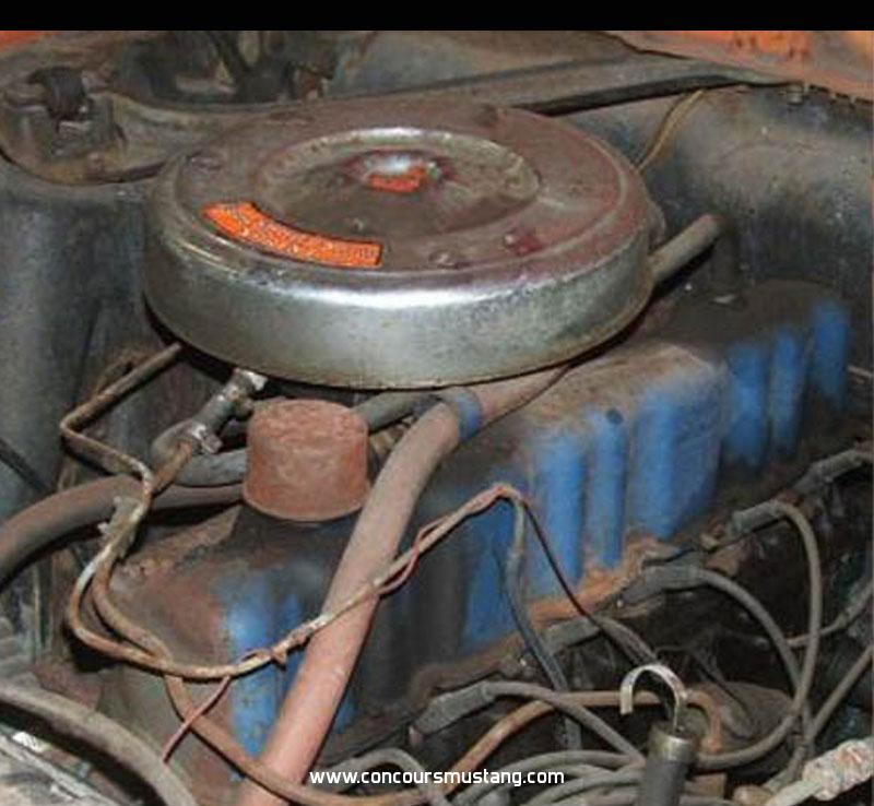

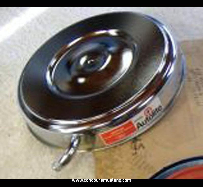

-Autolite spark plug air cleaner decal (DEC160) - Never seen one on an original engine - your size, plant and year. though if showing at MCA they will be looking for it so if you choose, top of air cleaner at the rear opposite the Sport Sprint

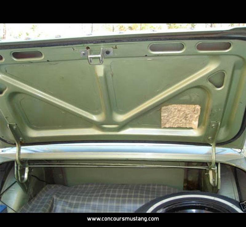

-Jacking instructions decal (DEC044) - Bottom side of trunk lid - One of two locations I would choose as shown in the picture based on your cars details

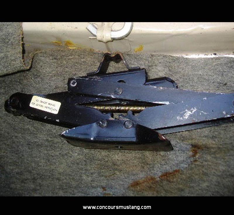

-Jack base decal (DEC036) - one the lower arm of the jack
-Air cleaner service instructions decal (DEC149) - Driver side of the air cleaner (side of air cleaner )

-sport sprint decal - Top of air cleaner at front

Thanks - picture added above

Added the trunk jack picture.
