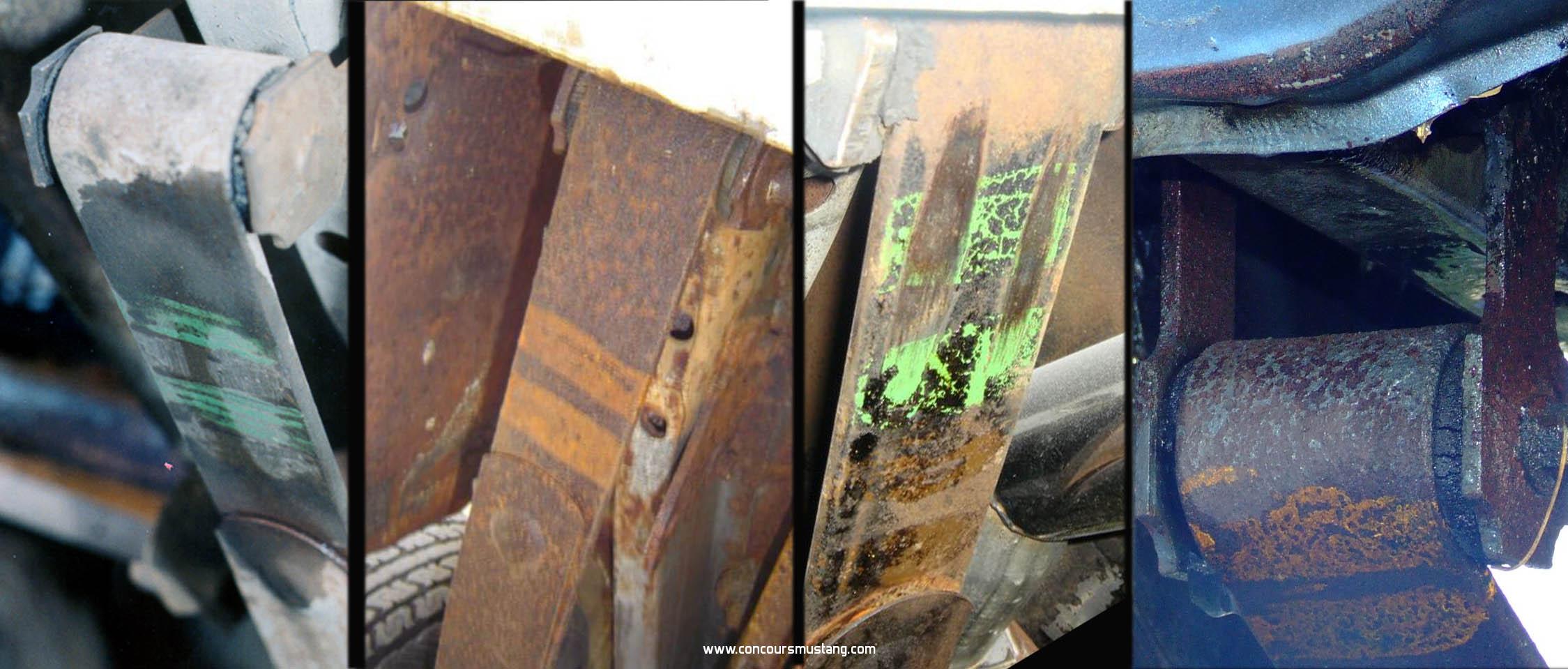

Front springs - 1 Yellow and 1 Tan stripe applied with the springs out of car
Rear springs (best guess based on buildsheets) if we also had the engineering number we could try and double check) - ! Gold and 1 Brown applied to the long leaf just in front of the rear spring eye

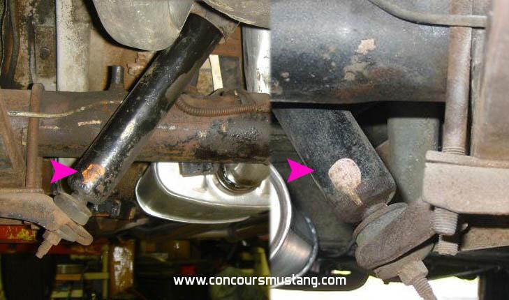

Front shocks are marked with a white daub and the rears with a brown daub. Should be able to do a search to show where and how shocks are typically marked

Thanks Jeff , I have read a lot of your post's and really appreciate your help , is there any pics avalible for referance , sorry i am new to the forum and still trying to work my way around it , thanks again , cheers
  • Posts: 24867
Re: 69 mach1 front & rear spring markings & colours
« Reply #3 on: October 07, 2013, 12:59:39 AM »
The search feature is your friend ;)   But if its an older post then you can often ask if the older info is the latest info or if something new has been found. Plenty of old info floating on the internet - much that has been adjusted as we have discovered new things
For others viewing this thread please do not use these pictures unless you have a 69-70 Mustang since your car was likely/possibly marked differently  :o

And some pictures ;)
« Reply #4 on: October 07, 2013, 03:59:54 AM »
Thanks Jeff these pics help a lot realy appreciate the help and the info i have come across is amazing so far , cheers
