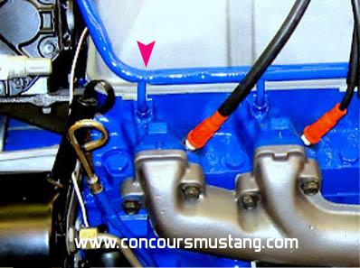

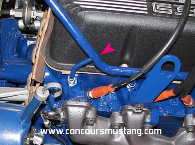

I thought Bob posted a picture comparing 67' and 68' thermactor tubes but I can't seem to find it now.
I am looking at pictures of 67' cars and I can't see the difference in their tubes and these;
The quickest IMHO way to take note of the differences is illustrated in the following two pictures. Top a 67 design the lower a 68-70 design. Hope this helps

That does help. Thank you
Is that the only difference?

On the 1967 left side GT500 thermactor tube is there a support bracket? The pictures 2112 posted I can't see the bracket...
Re: 67 GT500 Thermactor questions
« Reply #53 on: December 05, 2014, 11:39:16 PM »
Its cut/modified from the 390 application
