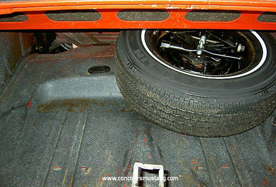

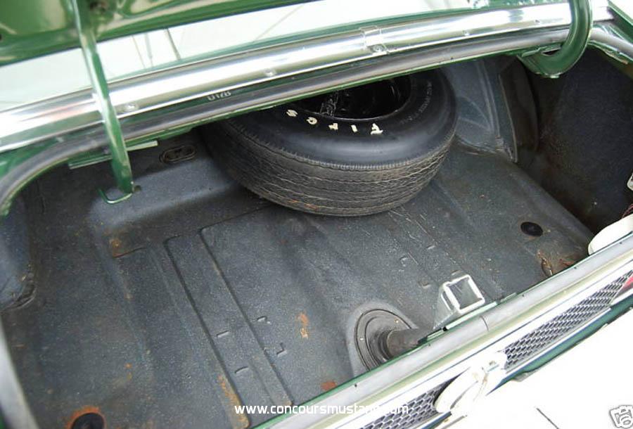

« Reply #1 on: December 19, 2014, 11:09:36 AM »
Mainly pictures of 72 as that was the car I was restoring.  I do have a few from a Boss 351 original paint car that went through Perkins collection several years ago.
The 71 uses the lighter gray and white fleck Zolotone.
One point to note if you have the folding seat and trap door, the trap door should be installed first as the lower third of it should be oversprayed with trunk paint.  Mine trap door was not completed yet when I painted the trunk so that is a project still to be completed.
I have seen cars with and without the side marker lights painted over with trunk paint.  Mine appeared to have paint on them and they were quite gunky originals so I chose to over spray with spatter.
Hope these help.

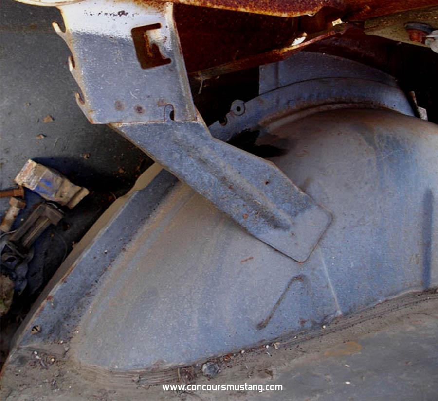

« Reply #2 on: December 19, 2014, 03:23:36 PM »
Couldn't find any clear pictures of the sound deadener as applied to the inner quarters. SO hard to make out the texture with the old fleck paint over it :(
Basically IMHO cover the inner surface staying back from the back edge by 4-6 inches, away from the top edge about the same follow the curve of the wheelwell moving forward but away from it from 6-8" as the pattern travels forward towards the front of the car. Believe like 70 the 71-73 the sound deadener was applied before the quarter panel was attached to the other panels

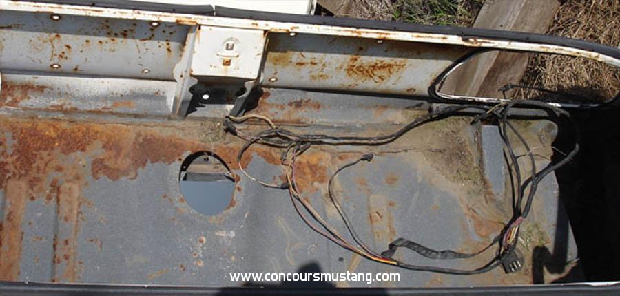

« Reply #7 on: March 25, 2015, 04:46:52 PM »
Yes, the PPG charts lists the light spatter codes for 69, 70, and 71 Fords. The PPG Ford charts for 72 and 73 Fords list the darker spatter. I've spent many hours looking at 71-73 Mustangs in junk yards in the 70s, and many hours at a Mustang only yard in the 80s. I have never seen a 71 Mustang with a light colored trunk. At the 429CJ Mustang Megasite we even have pics of 71showing a low mile unrestored trunk, and its showing the dark color???  I
wouldn't go by what you might JUST see on an aftermaket chart, especally if it wasn't updated correctly, or on time? There are plenty of unrestored 71 stangs on ebay showing the dark trunks, and there are also 69-70 big Fords there, showing the lighter gray, as those should. Here is an picture of the light gray from this 69 LTD.

« Reply #8 on: March 26, 2015, 11:11:09 AM »
Here's pixs of a 1971 LTD trunk . Look like the dark to me, espescially if you compare it to the gray on the earlier car.

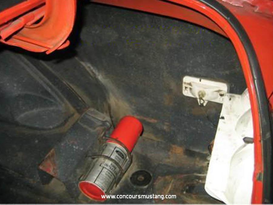

« Reply #14 on: January 10, 2018, 10:19:58 AM »
Looking at the picture of the car showing the filler boot it looks like there is no trunk paint overspray on it. I have read that there is now a point deduction for no overspray on the filler boot. Should there be overspray on the filler boot or not?
