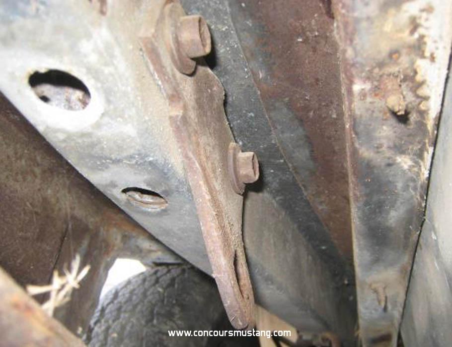

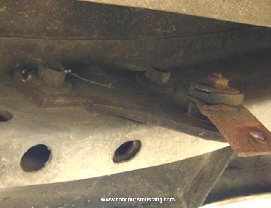

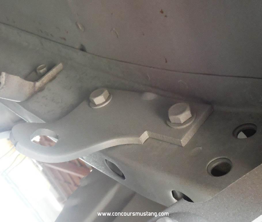

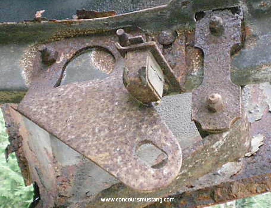

Some 69 Examples
9F02Q1348xx - Notice the difference of how the bolts were installed
9R02F1728xx
9R03F1144xx
9T02H1058xx

Was it just a preference of the line worker, regarding the orientation of the nut & bolt?   ~ i.e. nut on the inside vs outside of the frame rail.
Seem like most of the pics show the nuts on the outside of the frame rail, but a few have them on the inside.
Just curious if there is a rhyme or reason.

Probably just easier carrying the longer bolts already slid into the brackets in his one hand, while holding his nuts in the other  :o OOPS!
Routines are set up when you do things over and over again

The reason I mentioned that is so that members and Marcus could keep an eye open for that detail to see if its plant specific. Sometimes its a results of how the line at that particular plant was set up - what station they were installed at or instructions received by that plant's managers. The one I posted that was different was a Dearborn example while the others were San Jose in that set - like the 70 Dearborn example you posted.
Looks like the 65-67 San Jose was typically done with bolts in plate with a few odd balls here and there - possible a single worker at that station that liked them the other way.
May be nothing or may turn out to be one of those details we discover like the direction of the front spring/shock cover bolts on the earlier cars which is somewhat plant specific
We'll only know if there is a pattern if we pay attention :)

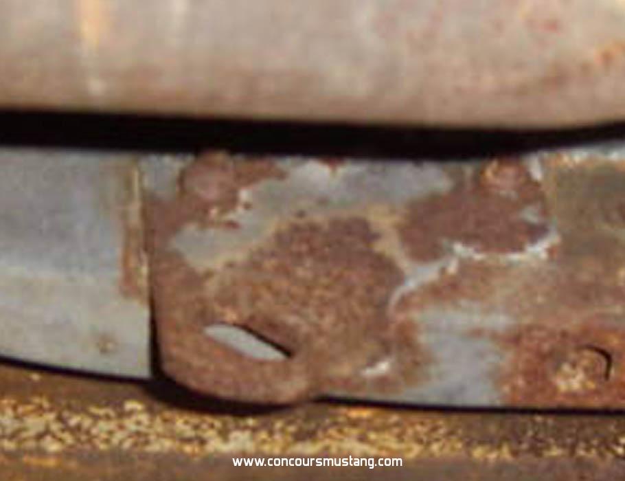

Another one from today's cars
8R02J104xxx tie down
