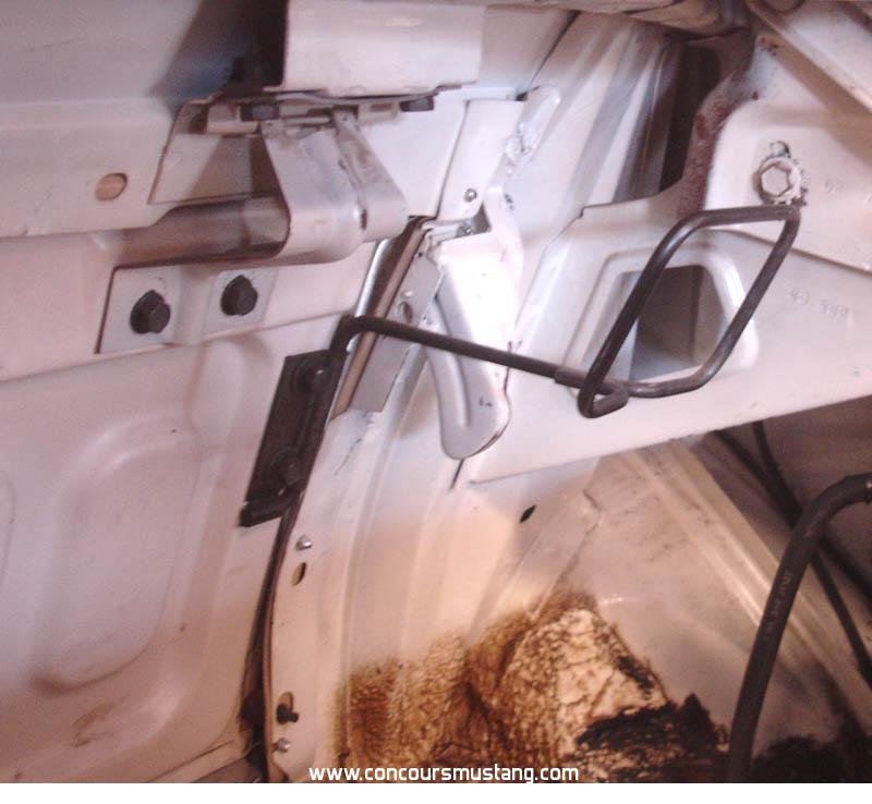

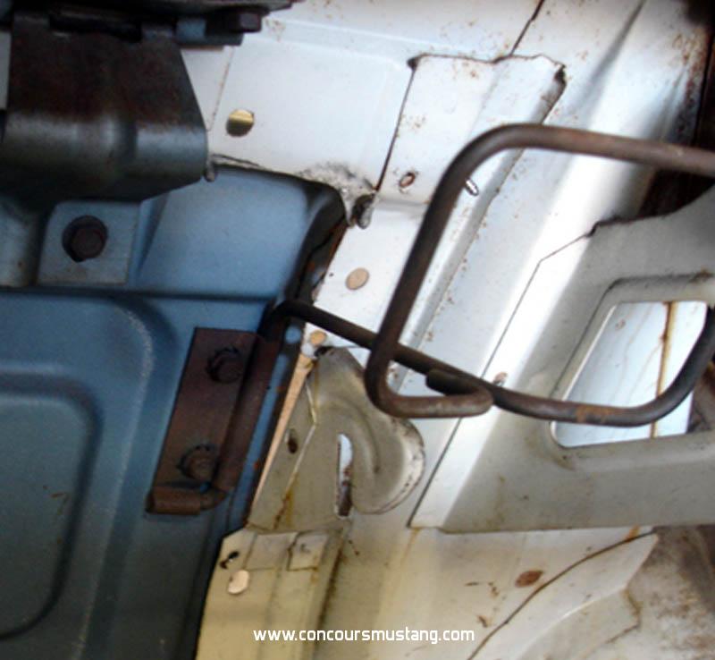

Here is an original example that shows a different between the rod and the base bracket as you describe.
Notice (lower right of the picture) the difference between the two P&O  parts in this example
Now more typical and consistent finishes

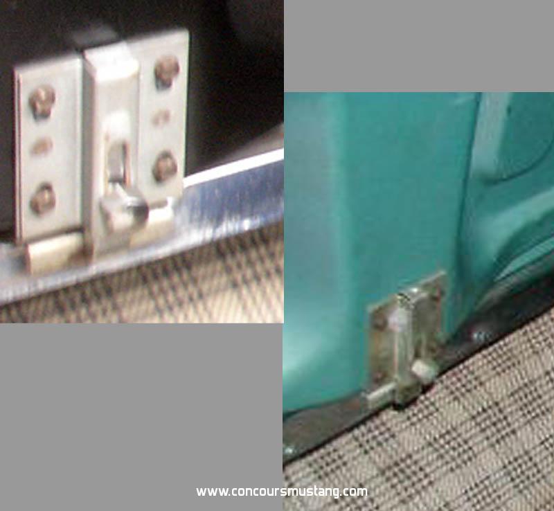

For extra credit, was the trap door latch galvanized or zinc plated?
Were the tiny bolts that hold the latch in place PO and/or something else that had a red tinge?
Have not seen signs on the back side (most protected from the elements) of galvanizing on this part. They appear to be made possibly by the same supplier that made the found down seat latches and the striker attached to the rear most fold down floor section/insert and appear to match in finish

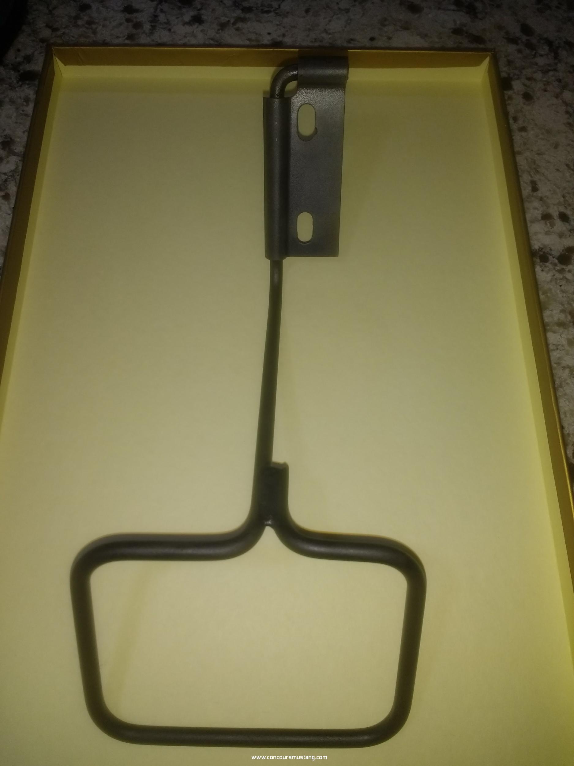

My trap door rod is identical (after black phosphate and oil) to door number 1.
After getting the manganese and zinc coatings from Palmetto, the two finishes can be very different.
Manganese is charcoal black (depends on material, temp, etc) and is usually imparts a color like fresh, black fender bolts.
The zinc is more of a dull, dark, battleship gray (again, depends on material, temp of material, etc). If you steel wool the zinc it gets shinier and a feels a bit like it's plastic coated. Very slippery. I love this coating.
To put the two in perspective it's almost as if the rod material of the prop rod were done in manganese (Phosphate and oil) and the bolt plate was done in Zinc and Oil.
Again, like  you say, it's really a matter of material, mass, temp of the material before it goes in the soup and many other variables.
Here's my prop rod:

I think the rod is similar to spring steel and the bolt plate is more like plate steel. The P/O can be absorbed at different rates given the same time exposed in the bath (darker /lighter) depending on materials . I think that is one possible reason why you see the darker lighter portions on the parts in your observations IMO.
