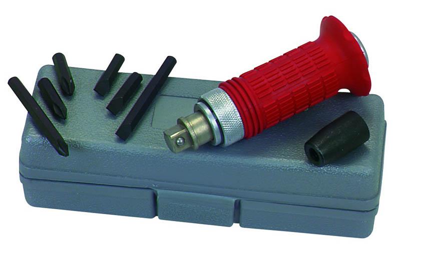

Thanks guys.  I will stop at Harbor Freight and see if they have a manual impact driver.
Re: Striker plate screw removal
« Reply #5 on: April 06, 2015, 09:56:46 PM »
They should ---- that's where my posted picture came from and where I got my last one  ::)

Have you tried using the proper tool first?  The striker plate screws use a Pozi-drive style head, not phillips.  There is a difference in the angle / the way the bit "bites" in the screw head.
Have used these in the hand impact tool in the past successfully. Just the steady tapping unfrozen the screws
