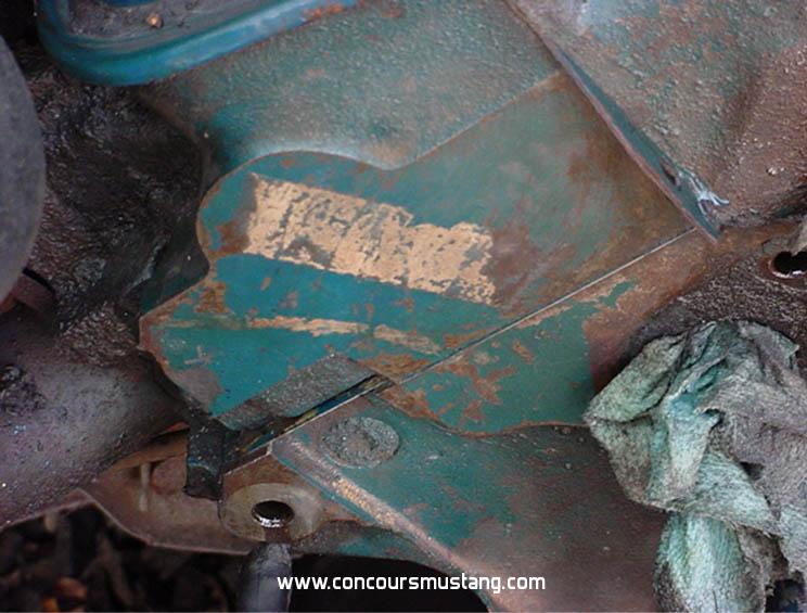

First DON"T BUY A DECAL KIT!  ;)
On lets see if I can get all of them from memory
1- Engine ID sticker - passenger side head front surface
2- Engine timing decal - drivers side valve cover outer surface below the breather
3- Battery inspection decal - black printing on basic sticker. No one sells on filled out commercially
4- Service decal - drivers side shock tower typically to right about inline between the two lower shock/spring cover bolt heads
5- Air cleaner cubic inch decal - top front center or lid
6- Autolite filter service decal - air cleaner base drivers side between dist dimple and vacuum door
OK. What about a Dearborn 390? Is this list still the same?
Since decals/stickers that were applied at the assembly plants they would differ in how they were filled out or sometimes supplier and often different locations while most if not all (depending on year  & plant) engine decals were applied at the engine assembly plant they would be more alike

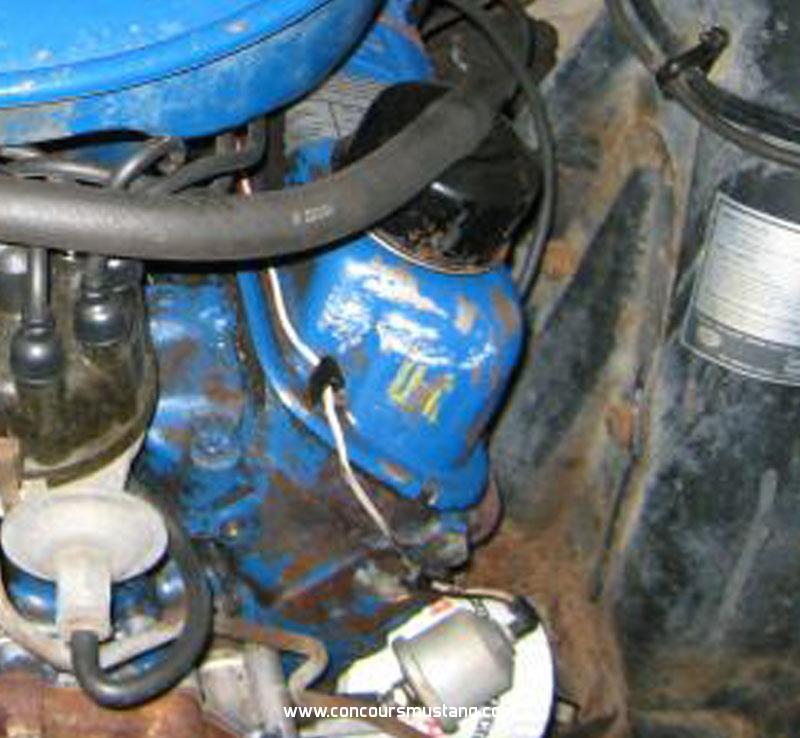

Ok. So where have you seen the engine ID tag? I've only seen it on the front of the drivers side valve cover.
For a 69 390 engine Have a question that may or not have a a bearing on the placement.
With or without the chrome engine accessory option?

With the chrome dress up.
Re: 69 Engine Bay decals & tags
« Reply #12 on: June 12, 2017, 05:30:07 PM »
From above
Same engine plant - different FE engine
