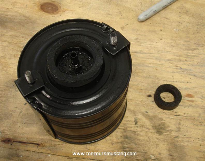

Reproduction front vacuum can being test fitted
Since we choose to use a reproduction we needed to hide the fact that it used a brass fitting for an attachment. We choose to black out the fitting since it was not the right shape and if we choose to go with a silver finish that would only tend to draw eyes to that fact. Not correct but will do until we find a nice original.

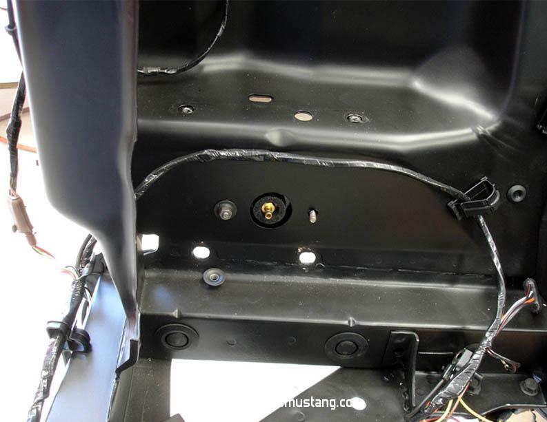

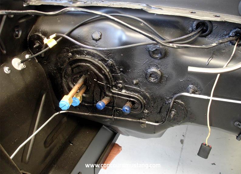

Shot of the rear vacuum canister and passenger side firewall finishes
