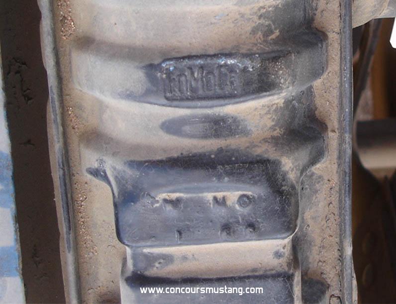

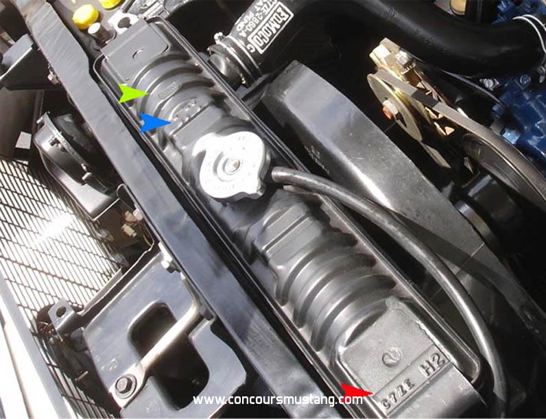

« Reply #10 on: May 13, 2015, 02:34:59 PM »
67 San Jose examples
Close up of date
Typical top tank markings for identification

Bottom pic in Reply #10 is a nice example of a '67 W-MO 289 radiator for a San Jose car.
See the top strap tabs on this 20" W-MO 66 - 9 radiator in photo below.  The corners of the tabs have square 90-degree cut corners, instead of the rounded/radiused corners on the Reply #10 example above.  Assuming the rounded corners are correct and square corners are not?

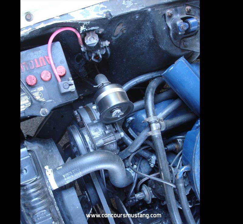

Thanks for the additional info Jeff.
Here's another thread: 67 San Jose Convertible C Code Thermactor w/AC-Unrestored Picture Thread 67 San Jose Convertible http://www.concoursmustang.com/forum/index.php?topic=8272.0
Photos E3 and E11 show similar rounded corners on the straps, on a '67 C code.
E3
E11
Here's another thread: 67 San Jose Convertible C Code Thermactor w/AC-Unrestored Picture Thread 67 San Jose Convertible ............
Yes unfortunately that one "lost" its identification tag/label when it was likely rodded out some time in the past. Was and or is an air condition car, reason for the extra cooling style radiator. Likely have more than 100 picture examples with this particular style of radiator

Jeff, I think your round-top bracket radiator pictured (now removed) here may be a 16-inch radiator (I-6 example?), noting what looks to be the wider side bracket at the lower edge of image (not completely seen in this image).
Aside from this, my understanding is that any 289 with Thermactor & Select-Aire would have Extra Cooling option (also K-codes too, even w/o Select-Aire). Other 289's WITHOUT Select-Aire would typically receive a 20-inch STANDARD cooling radiator. I have not seen any 289's with a 16-inch radiator (though I would never rule this out for Eastern/Midwest DSO's). I did not look at the MPC to confirm any of this, only reporting my personal observations over the years which were mostly Western DSO examples.
