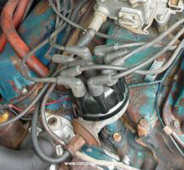

You've likely been looking at cars that were "restored" or from other plants, options and time periods
Looks like its passenger side head for your application
7T01C119xxx
7T01C149xxx
7T02C199xxx
7T02C237xxx

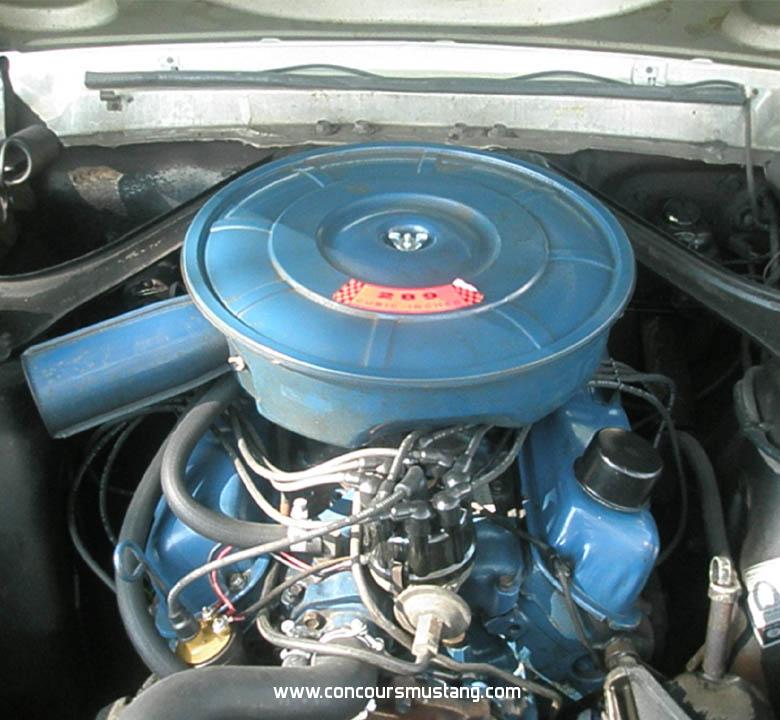

All of them from any plant were mounted to the intake bolt on the passenger side. This engine photo has a lot of problems but the coil location is typical.
« Last Edit: July 26, 2022, 10:31:54 AM by RoyceP »
Picture you posted is of
Based on unrestore a 68. Appears that the poster was looking for 67 non-thermactor applications
Based on all the examples I have the original location would be a carry over from 66 and attached to the face of the passenger side head as shown in the earlier threads about the same subject. Used the words "67 Coil location" and it found them quickly
Will be merging this thread and one of those so I don't need to post a link  ;)
Re: ignition coil location
« Reply #11 on: July 26, 2022, 07:12:46 PM »
True - I don't know why I chose to picture a '68 289. The '67 of course normally mounts on the cylinder head on the passenger side in non - thermactor applications. If the car was to be sold in Arizona or California when new it would mount like a '68 - on the passenger side of the intake due to the requirement for thermactor in those states..

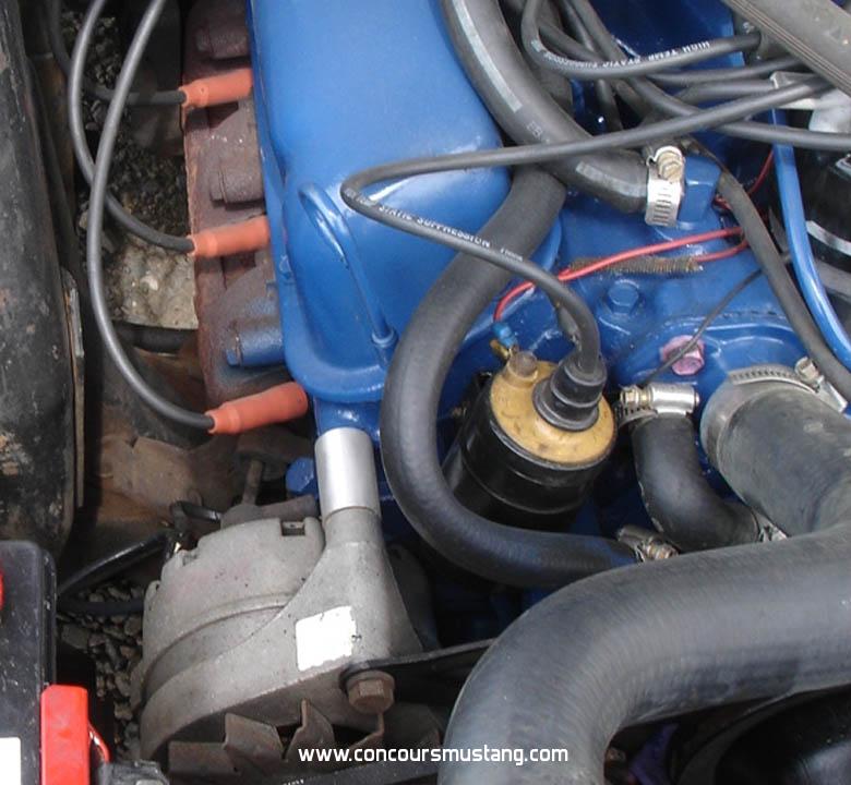

Late 66 on mine, none thermactor. SJ.
« Last Edit: August 10, 2022, 01:20:15 PM by Ralf »

I know that you are concerned with assemblyline originality based on your past posts. With that in mind I thought I would mention that the ID sticker on your coil was most typically placed long ways along the body of the coil up and over the coil bracket and not along the coil bracket like you currently have it. Also the alternator is a later production rebuilt unit as indicated by the metal stamped engineering number (post March of 1969 ).
Re: '67 289 A code igntion coil location(Metuchen built)
« Reply #14 on: August 10, 2022, 11:55:20 PM »
For others viewing the wire ends/boots at the coil are incorrect. Just in case others are looking and thinking of copying  as well as things Bob mentioned and the bypass hose clamp as well as clamp and hose finish
