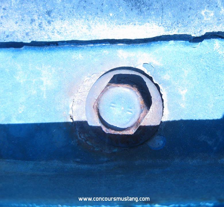

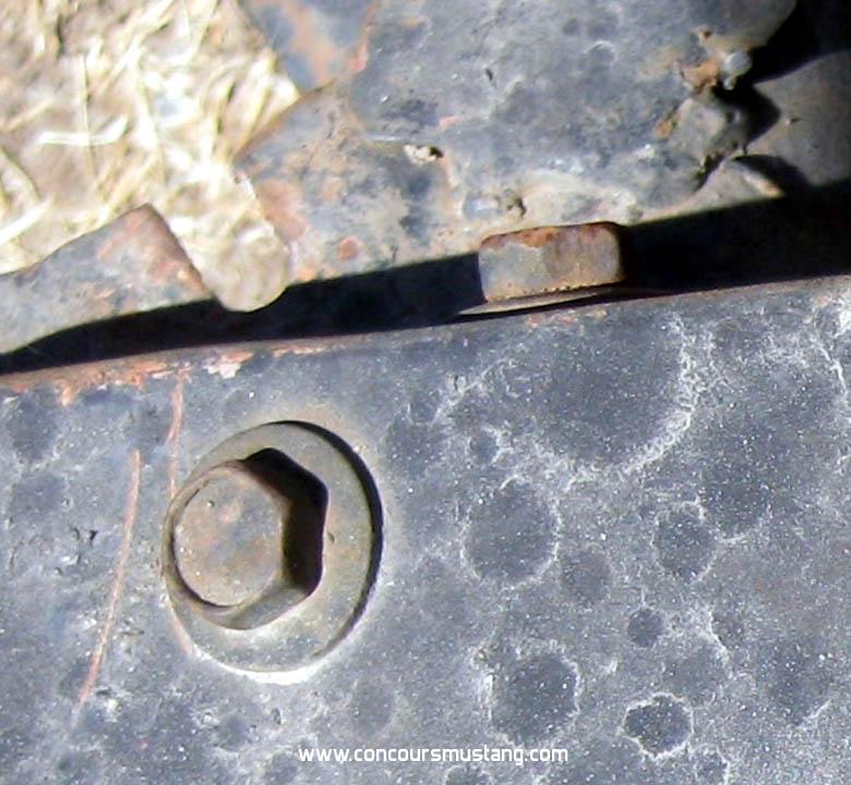

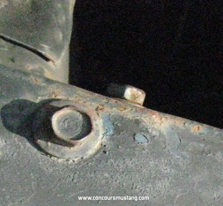

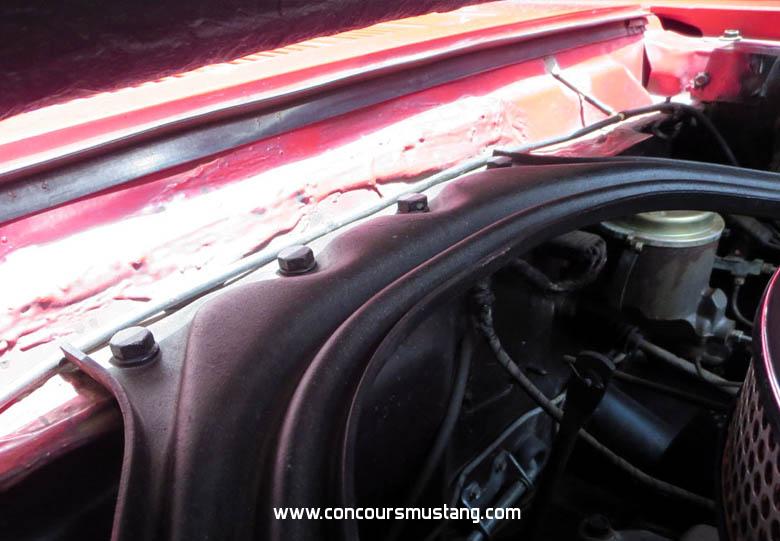

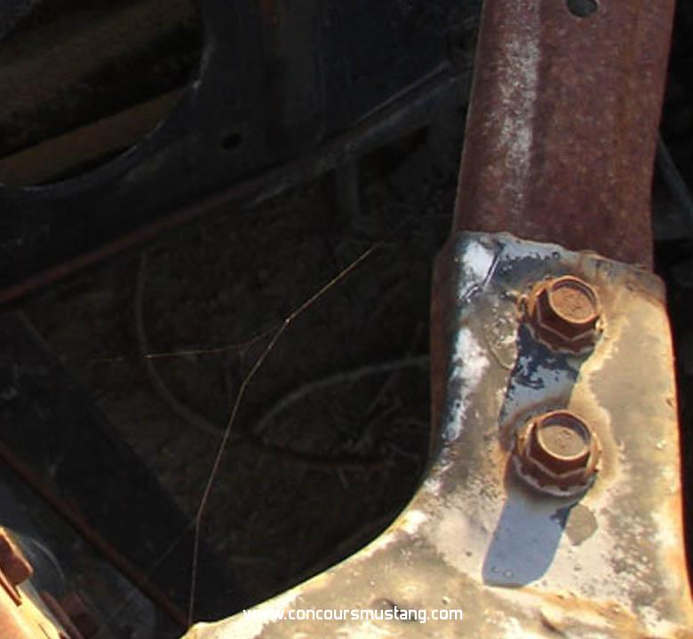

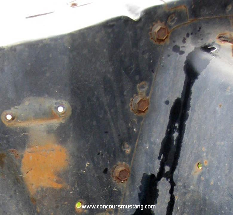

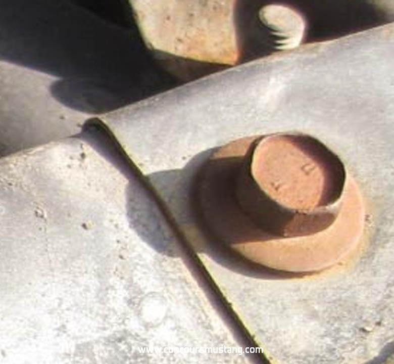

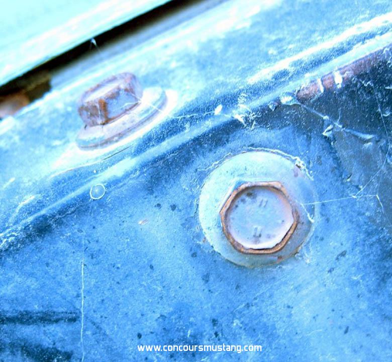

Having looked at the Ford vin you provided it appears IMHO that the car was likely built during the Feb-Mar 66 period at San Jose.  Corrected the thread title to reflect that
Looking at original cars around that same vin (Seem to have plenty in that range) I found the following examples/data
- Looking at a bunch of cars within five thousand vins lower and higher that the vast majority used flat washer bolts at both the inner (shock tower covers) and outer (fender) location. Have maybe 3 examples of start out of maybe 20 cars - for a ratio to give you an idea of why I would recommend the flat washer use
- Head markings included both the double hash "" and the SEMS

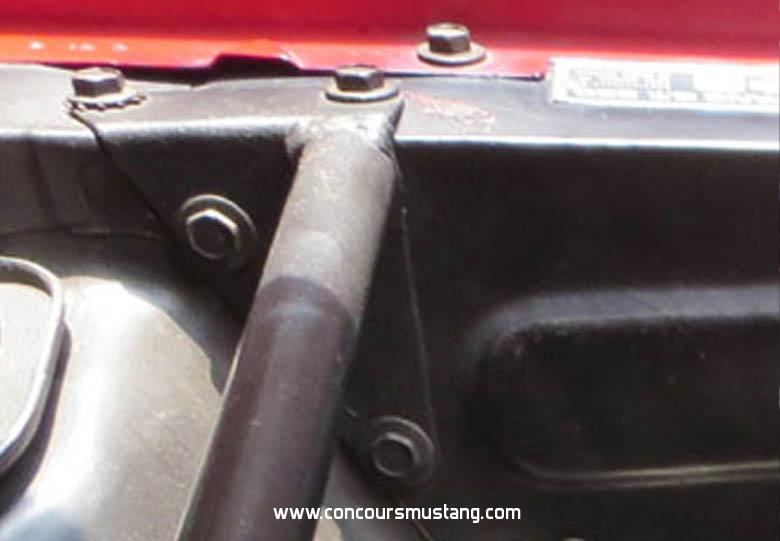

- Since you have a Shelby and that some of the shock tower bolts were removed at Shelby to install the Monte Carlo bar the forward upper bolts were rearranged when they were reinstalled. Since the bar requires an additional bolt being added it is normally of a different style. In your case I would expect a star washer bolt to have normally been installed in one of the two upper bolt holes (picture below.)
- Threw a few other bolts in to help out - Sorry haven't always taken clear closeups of head markings but we can go through specific locations rather than just blast a bunch of bolts up in one response

« Reply #4 on: May 30, 2015, 12:49:10 AM »
Thanks Jeff.  I noticed on the last pic there is a bolt with a star washer holding the Monti Carlo Bar.  Is that random?  Looks like the safe bet would be the double tic marks since it falls within that 174xxx range.  BTW, car was shipped to Hertz mid/late March.
2009 V6 Mustang Coupe
  • Posts: 24919
Re: Fender Bolt Head Markings for a Feb/March 66 built GT350
« Reply #5 on: May 30, 2015, 01:07:31 AM »
Mentioned that earlier in that post. The use of a star washer bolt was typical for your period of time at Shelby. All three Mustang bolts were removed then replaced with the addition of one extra since they had to drill an additional hole forward for the bar. The start washer bolt could end up in any of the four holes but pictures of original cars show that typically it was one of the two top bolt holes is where it typically ended up from what I'm seeing
To add- the star washer bolt ended up in the new hole more frequently then the other way around from my observations but as Jeff indicated the bolts were taken out so with out a protocol they could end up any which way. My preference is to replace the bolts as they were originally from Ford assembly and the star washer bolt in the new hole which would be the preference logically if there was a protocol. But that is just me.

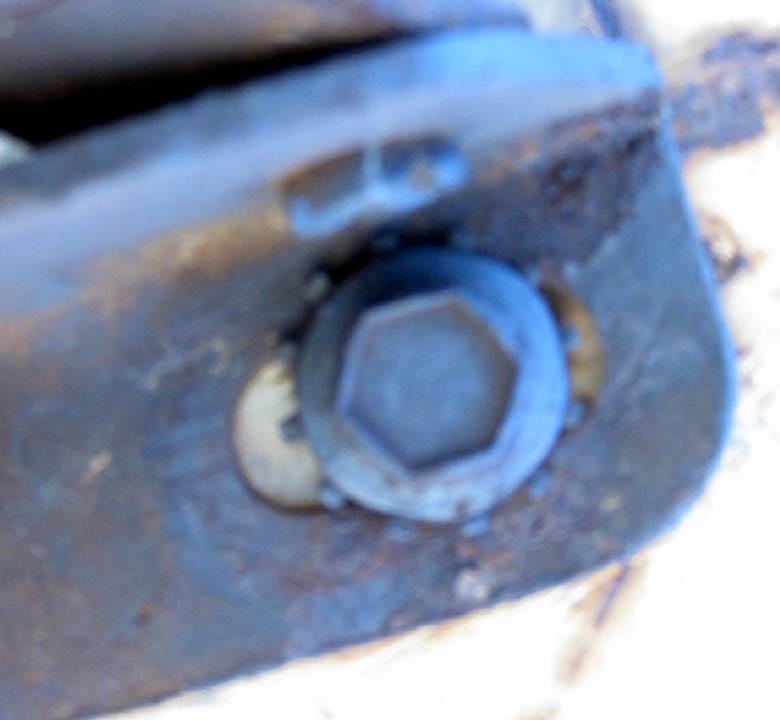

« Reply #14 on: February 23, 2017, 11:57:42 PM »
It would be safe to assume these bolts are aftermarket that are currently holding the hinges on correct? Never seen this head marking
