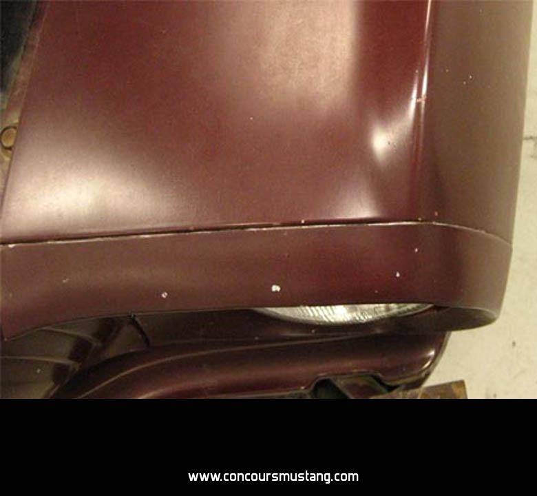

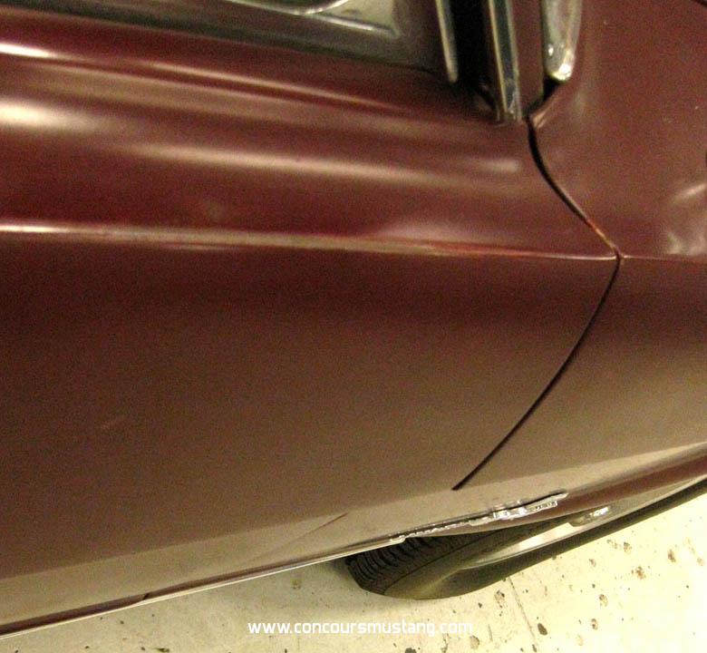

Tried to stay with original paint cars in most cases or at least non repaired.  Just to start out the pictures I found this one interesting in that even though the car is somewhat rough (depending on where your from)  the alignment (door, quarter and headlight extensions/bezel) still looks pretty good after all these years
Will label each picture just in case the discussion needs to focus on a specific picture ;)

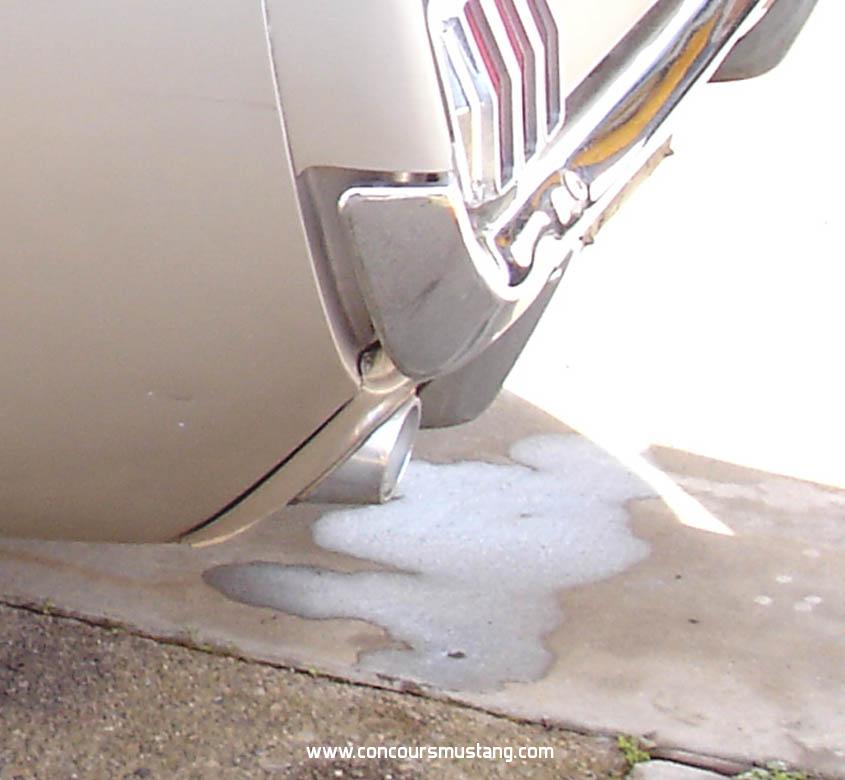

1A

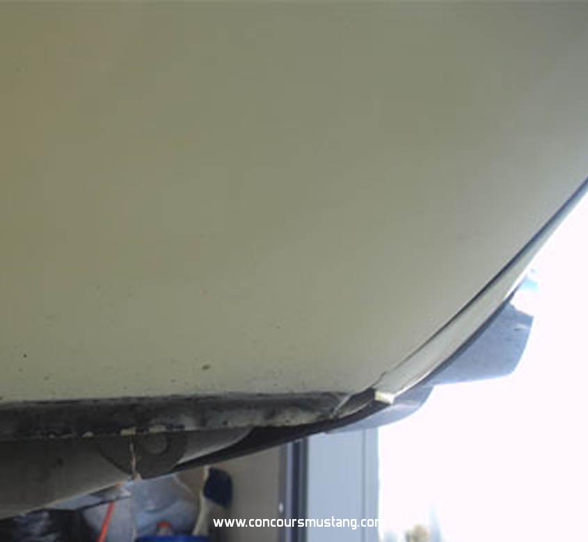

Just rear valance examples

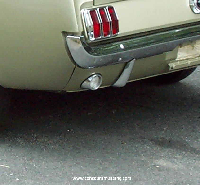

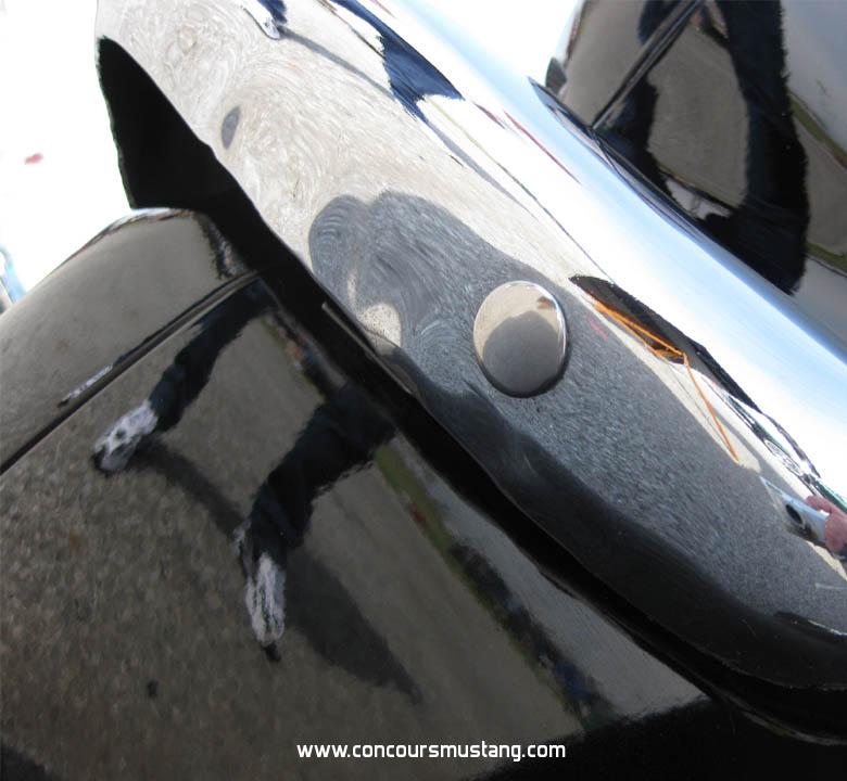

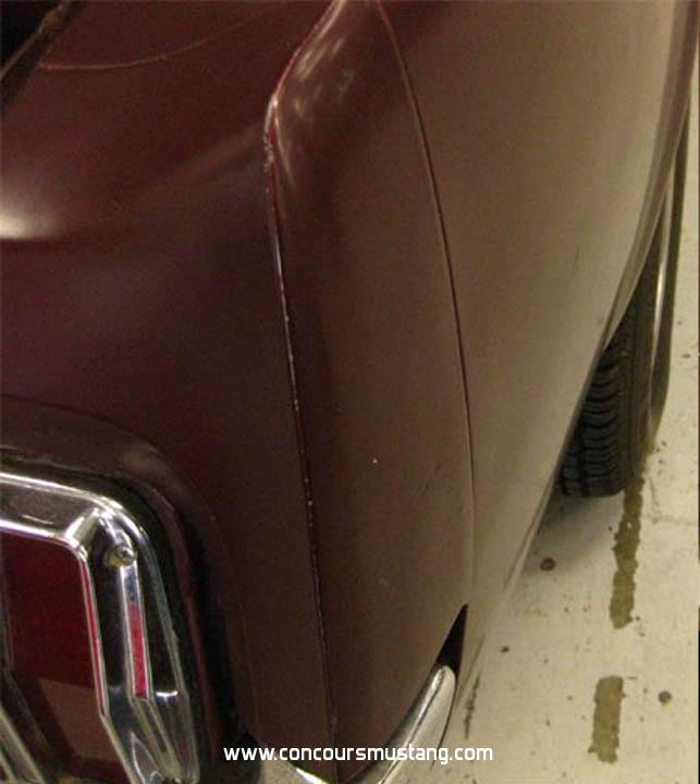

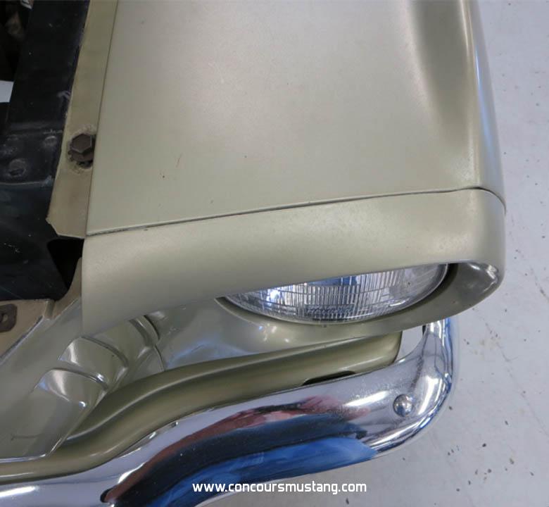

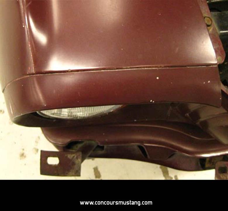

More- Angles of the pictures can effect the look/size of the gaps so tried to choose pictures that showed either fit or gab without exaggerating anything
First a couple that include a close up of what is referred to as factory orange peel. Noticeable in the reflections
2A
2B

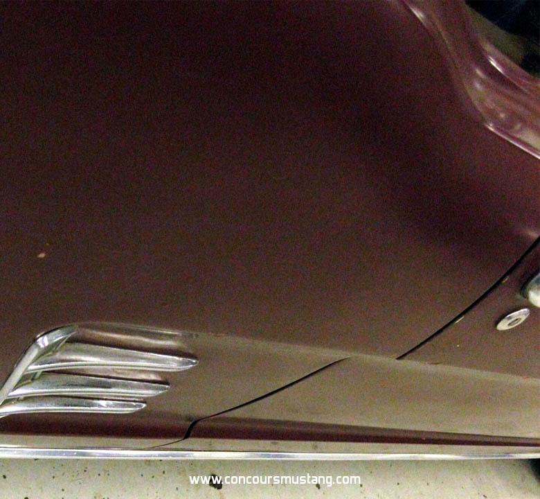

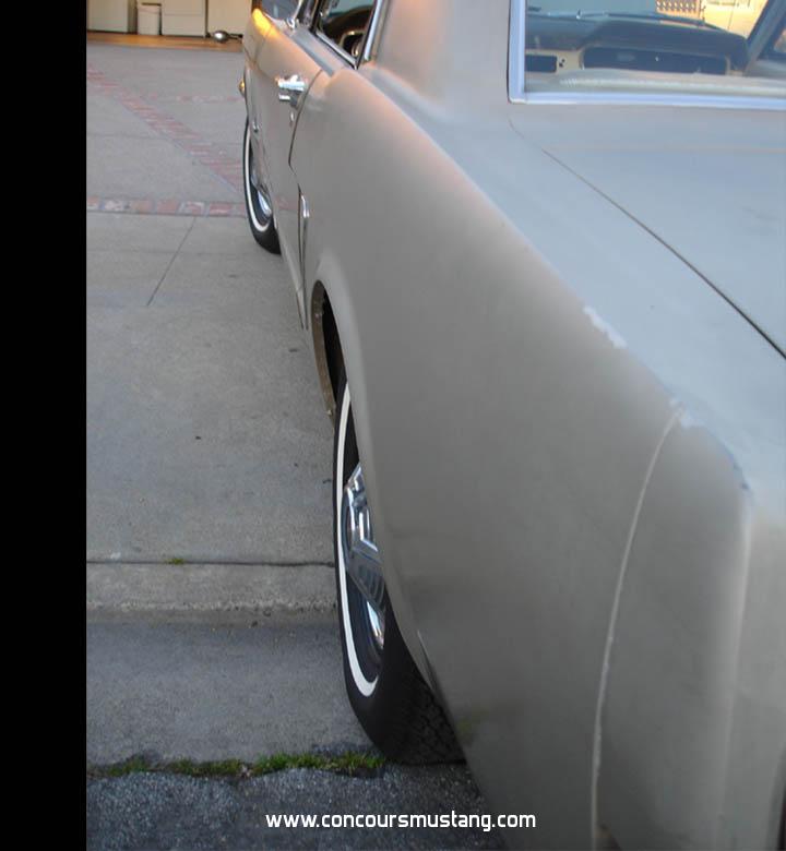

"Parts Car" we picked up for someone  ::) a few years back. One repaint without the jambs. Never found any body work under the repaint and only a couple of little dings after.

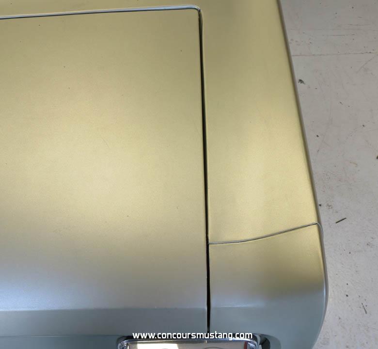

2C - Hood is slightly open in this shot
2D - Hood is slightly open in this shot
2E
2F

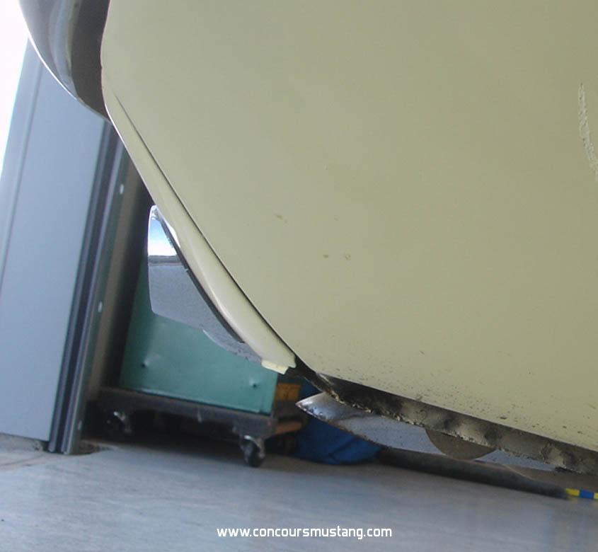

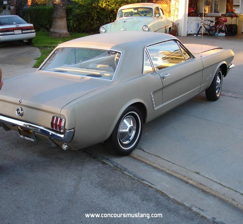

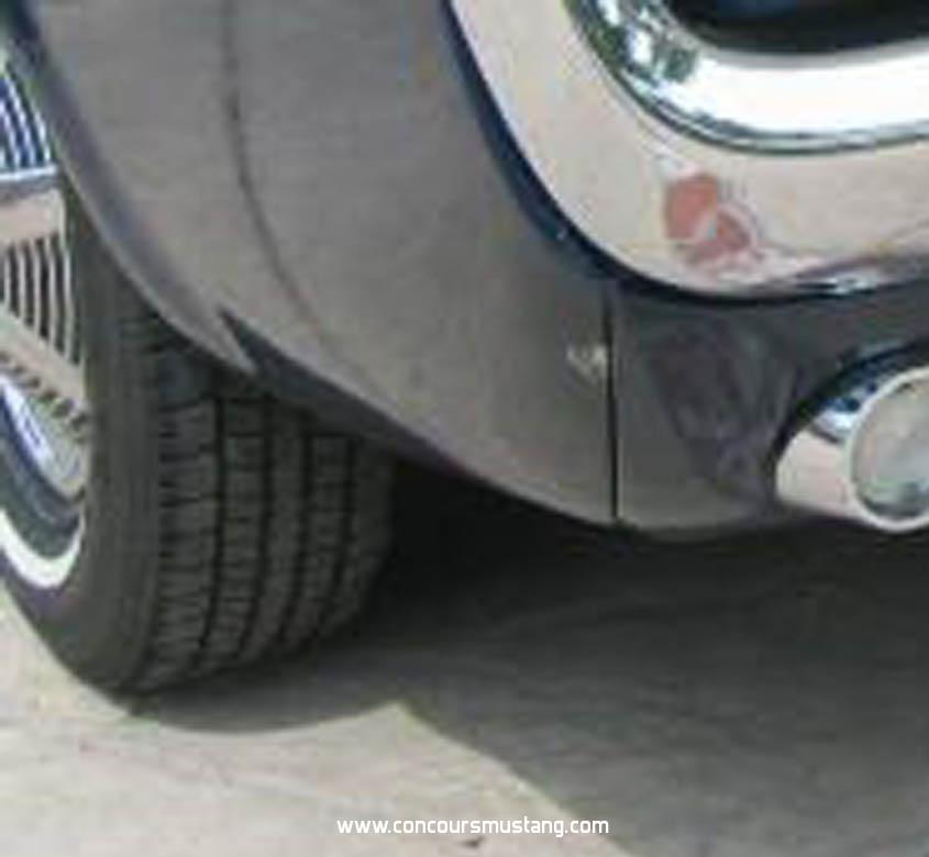

Just a decent coupe that came into a local body shop. Nice fit on a well used (think it had over 130K miles) driver
Always focus on those unibody, suspension and engine related details - rarely slowing down and taking many interior or body/exterior pictures :(
3A
3B
3C
3D
3E

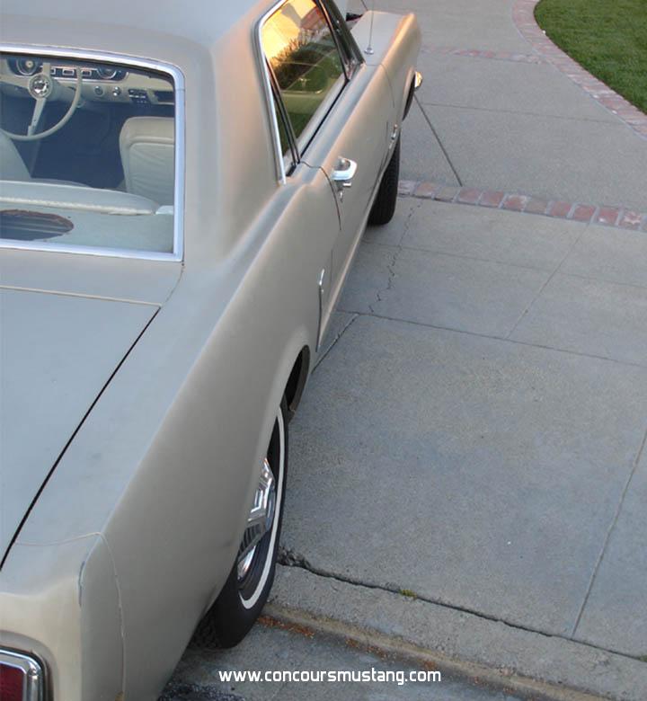

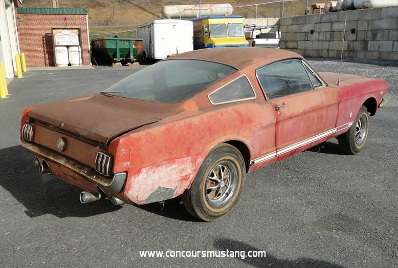

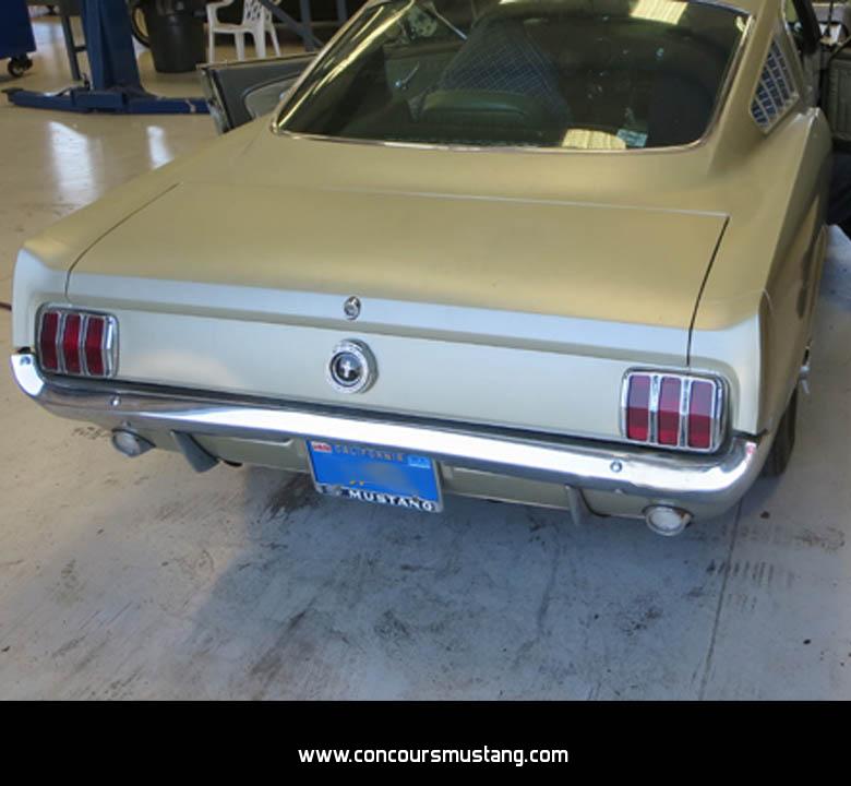

A fastback that we focused on in its own thread a while back
4A
4B
4C
4D

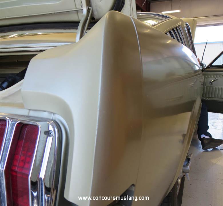

« Reply #12 on: June 13, 2015, 04:09:20 PM »
I can't see the hood in this picture. What I see is a pretty large gap between the door and the quarter, is it this you are referring to?

« Reply #13 on: June 13, 2015, 04:27:37 PM »
No  in the long post just put the comment on the picture above where I intended to place it. Fixed
If I recall correctly the fit of the doors was pretty even and nice. Though the drivers door front gap appeared that someone had caught the door and tweaked it slightly at the stop arm of the hinge.
That particular picture (one you reposted)  might be a good example of - the angle of the picture making things look tighter/wider than they were as mentioned in the text
