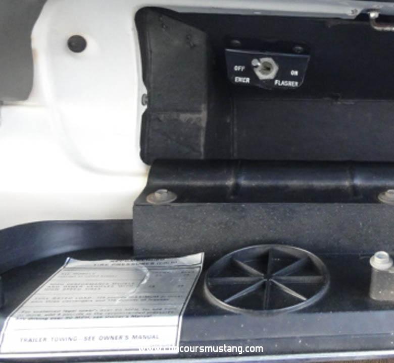

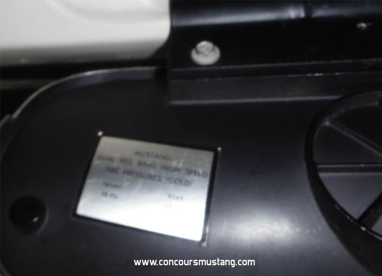

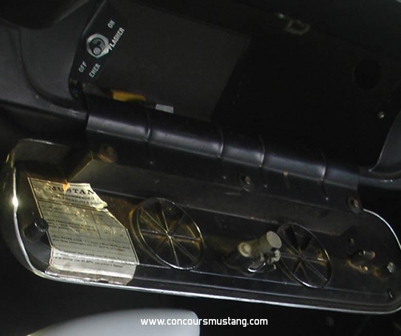

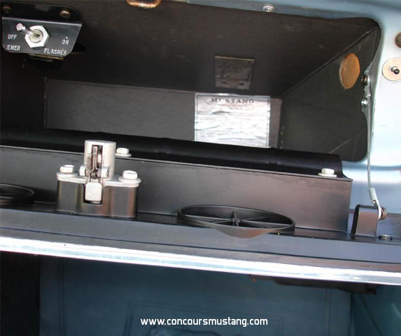

Question came up so while I went through the pictures and collected my data I thought I would share the results here also
Question was - Where does the tire pressure decal go on my 66 Shelby/Mustang? Of course we looked at the car's VIN and best guessed the time period for a best answer at this time.
Looks that the location may have changed somewhere between VINS #127xxx and #157xxx The latest I found attached to the glove box door and the earliest I found applied to the back of the glove box liner.
While we're there take notice of the emergency 4 way flasher switch bracket to the inner liner also. Just a bonus detail while we're in the area ;)
Can you pick out the glove box liner that has been replaced??  ::)
Hope this helps others
6R08A117xxx Tire Pressure
6R09A127xxx Tire Pressure
6R08A203xxx Tire Pressure
6R07C213xxx Tire Pressure

For some reason that I cannot recall, I thought the red line tire decal went on the back of the glove box and the regular one went on the glove box door?

Offline ChrisV289

I was looking at the rules just now for Shelbys in concours trailered/driven and it says either on inside of glove box door or in glove box back left corner.  So would the rules need to be updated based on the pics below showing them on the right?

Thanks for the plug.
6R09K121xxx has the sticker on the LH side of the glove box door. It's rather eerie as the upper right corner is lifted as in Jeff's first picture. I found no dual redline sticker, but I've had the car for only 19 years. It was originally equipped with dual redlines, the original spare sits in the trunk, unused.

« Reply #8 on: June 10, 2015, 05:31:48 PM »
"Have seen only a couple of cars that originally came with red line tires and if I recall correct those decals were on the door."
Yes, The Redline Decals are usually located on the right side glovebox door when it is the down position.  It is usually placed in the area near the Glovebox Cable hold-down nub on the glovebox door.  Again, I'm with you, I do not remember plant specification, but that's where I remember it.. I may have pic somewhere... I'll look for it.

« Reply #9 on: June 10, 2015, 06:07:32 PM »
A little off thread but did find a picture of an original 65 unrestored K code Convertible - 5F08K364xxx, I took some pictures of a few months ago.
One decal - the red line one (still has original glove box liner)  On the glove box door to the left. Knew I had at least one from an original car :)
Which glove box liner was replaced?
Which one - the second one from the top in my first post.
Owner reinstalled the 4 way flasher back in a spot other than original and liner does not have the opaque lens cover over the opening for the glove box light in the upper right
