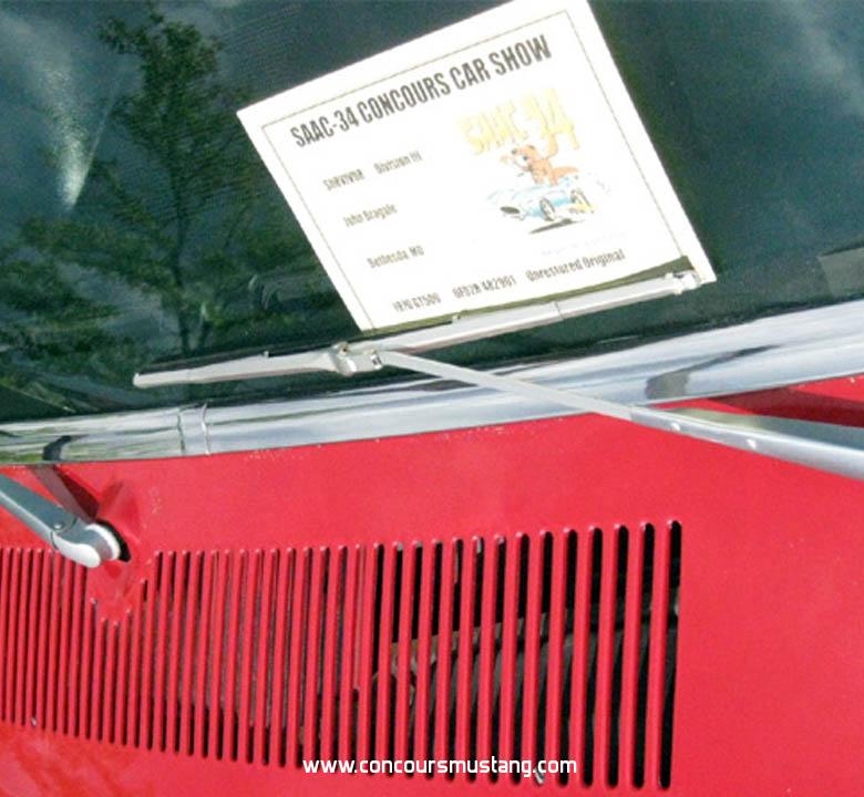

The c9zz antenna kits I had have both c9za & c9wa gaskets with them in brown bag. The 292 cast in bottom of the base ids the correct 69-70 mustang factory mount. What is your cougar id on base as I thought the cougar antenna was the same as mustang but just the gasket changeover angle to fit the cougar fender angle or curve ?  Never seen 69 Shelby antenna mount like in your red Shelby pic as way to short of antenna tube for a pm-300 unless somebody shortened the lower tube.  just sayin :)

Believe you have. That was the red GT500 unrestored car that showed up to SAAC a couple of years back. It was parked in the end of the row to the right (coming out of the hotel) of all the show cars we all judged. Know Bob and I spent some time talking to the owner and taking pictures. Length of the mast is another thing. Car number 0F02R482901.
Are you referring only to the tube length or where the strap attaches on the red car?
