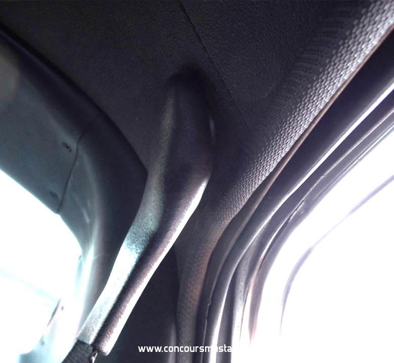

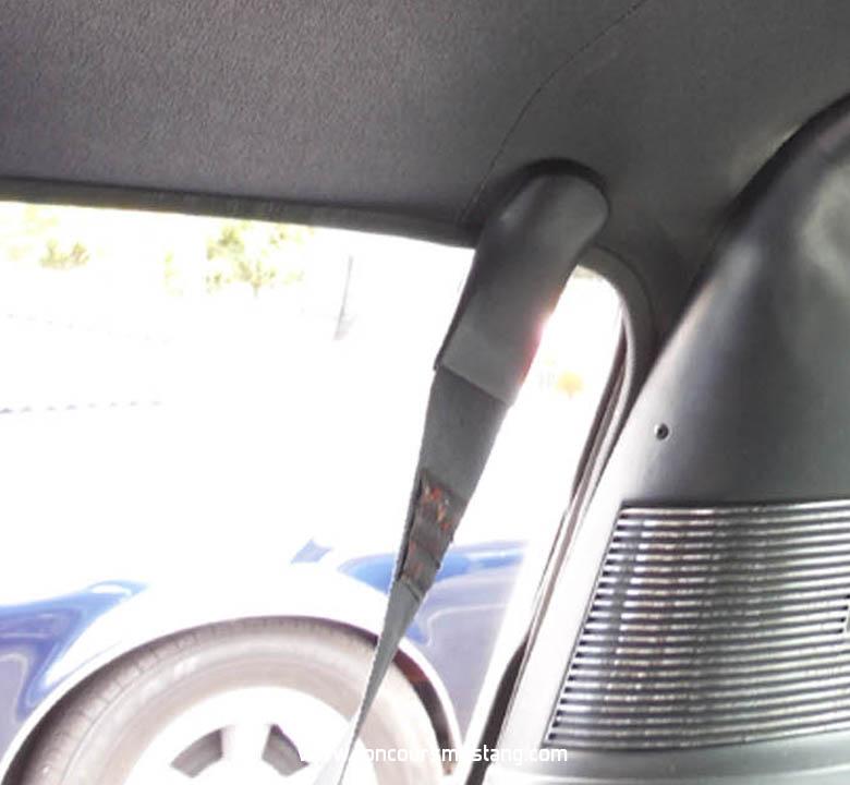

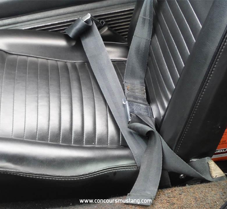

Almost forgot to post this example - was labeling some pictures from last years collection of shows.
7R02S202xxx
Since we haven't been showing much of the matching lower belt

Sorry to drag this one up, but when looking at the 7R02S202xxx pictures that Jeff posted, I noticed that there are no coat hangers, whereas 7R02S104xxx does.  I see that 7F02K156xxx has coat hangers but they are behind the belt attachment point.
It also looks like 7R02S104xxx is attached much further back than the other two.
Finally I can add one more car to the discussion, 7R02C176xxx.  Located like the 156 and 202 car, and no coat hanger.
