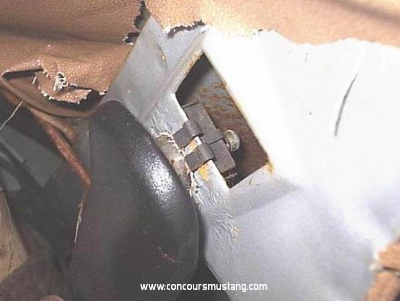

I have had requests for the clip, it was also used on very early 1968's
It is the Type 3 clip shown in this AMK catalog, note the Ford part number(s) associated. ........ and they are obsolete according to AMK.
I have been unsuccessful in removing them. Broke the only 2 that I have in the yard.

I was able to find a 3/8x16 j clip (similar to the fender j-bolt) at NAPA auto that did the trick for mounting the bolt.

Would not want to rely on a J clip for an anchor point in an accident  ::)

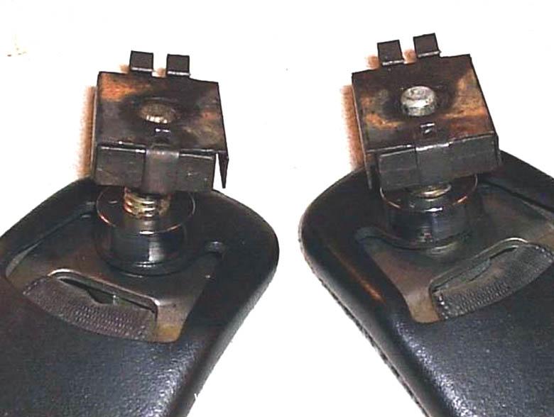

Couple of pictures of the large capture nut/mount

FYI the generic name for these is "cage nut". There are similar ones out there from different suppliers, but I haven't seen any with the double "hooks" on one end.

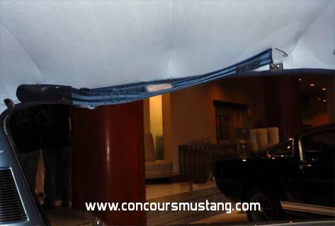

Apparently they came in colors other than black if this is a correct restoration. No reason to believe it isn't.
Blue interior - blue shoulder belt. From the Mid-America show this last weekend
7F02K156xxx  built 2/20/67

Thanks Jeff.  An assumption debunked?  Or another 67 running change?  Would need a lot more data naturally
Re: 67 shoulder belt option
« Reply #8 on: June 23, 2015, 07:04:20 PM »
Added VIN and real build date - that I should have included with the post :(

It looks to me like a 68 set up with the SS front hook/ hanger. 67s were not like that.
Yes it looks like a 68 style but I've not seen any original ones at that end.
Might ask Jeff Y next time you see him - he did the car and it was judged at MCA a few years back

The only one I have seen is Mike Poston's 67 K code fastback. R-A Motorsports did it as well. Stewart of Python did the belt restoration on it. I'll get pictures of it the next time I am there if I can.
No reasons to take pictures the picture I posted is that car.
Wow I judged that car at the Des Moines IA. MCA national and did not remember that front retainer. I did not know Mike then but thought at some point that we had discussed that Stewart had done the correct front retainer. I am sorry that I did not have my facts strait. I do know that it does have the option listed on the Marti.
