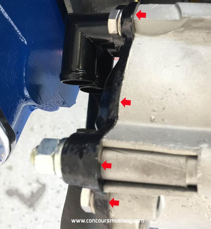

I have a 1967 GTA S Code Fastback San Jose early December Build. I'm assembling my 390 engine and trying to work out all the kinks. I ran across several setbacks assembling it, but finally figured out bracket locations. I'm still have a space issue on the power steering bracket. Also, is the cast smog cast smog pump bracket supposed to be bare cast? Here are some pictures of the motor. There are missing smog hoses and fittings. Please pick apart it and let me know if anything is missing or if I could do something better.

hard to do using my I phone but until I get to a decent monitor-the cast smog bracket is engine color. You are missing the PS pump bracket bare steel spacer.

- Where the water hoses (heater and radiator) connected would not have been originally painted. Instead masks were placed over the hose attachment points
- Looks like the Thermactor pump adjustment bolt washer has the ears one in one out - good :)
- Face (surface facing forward once installed) of the rear cast bod was natural not painted. Appears in #2 and #5 sections are black
........the cast smog bracket is engine color. ...........
+1 including those mounting bolts that hold it to the engine block
Not sure what you are talking about.
So, I need to paint the smog cast bracket blue?
are the bolts for the cast bracket need to be painted blue?

Front face would have been machined after paint so you would not have these tail-tail signs of black paint here and there on the face
Yes and Yes
Thanks Travis
I am skeptical about the fan clutch as I have not seen that style used on 67 SJ engines before. P/S dip stick appears to be later style. 67 had printing stamped on the thumb pull. You have a 70 and later style alternator fan. 60's version has less vanes.
