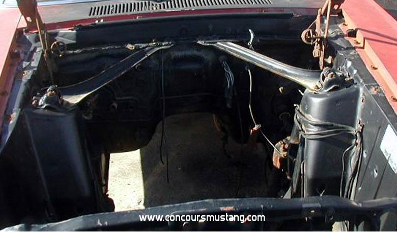

Let me find my a close up but you can see the braised on washers in this pic
I have owned the car since 1972 and began resto many moons ago but things are restored the way they came off, In the case of the shock caps, phos plated.

Thanks for the picture.  Just what I needed.  I know what those are.  I didn't know they were on the 69's.  So I'll guess a Shelby ?   You might try a search for some paint colors and stripe applications as I know this has be discussed before.  Some interesting details in your engine bay.  The firewall brake line clips are different than what's on my ride.  Yours is a manual drum and mine is power disc.  Of course the distribution block is also different.  Shock tower wraps so a 428 car ?   Brian

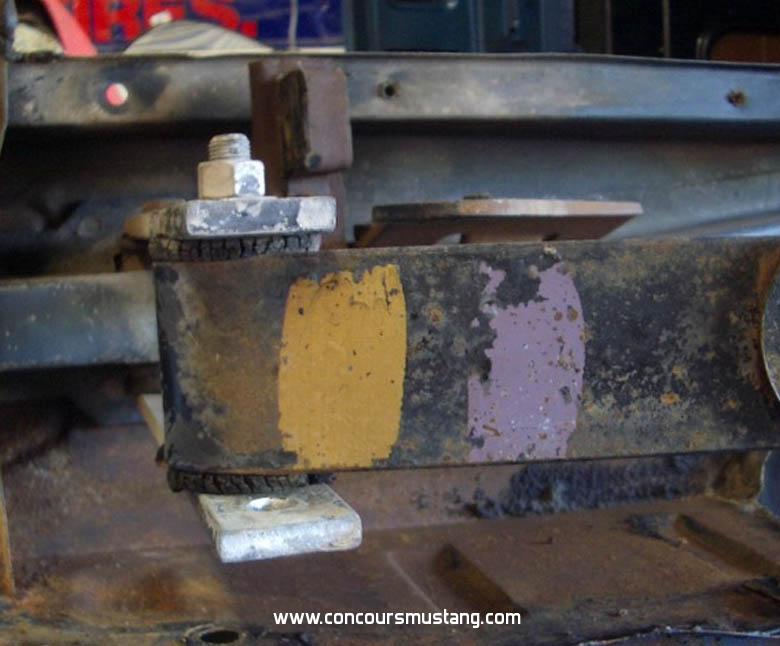

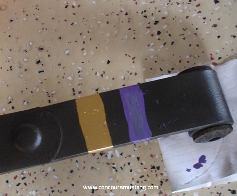

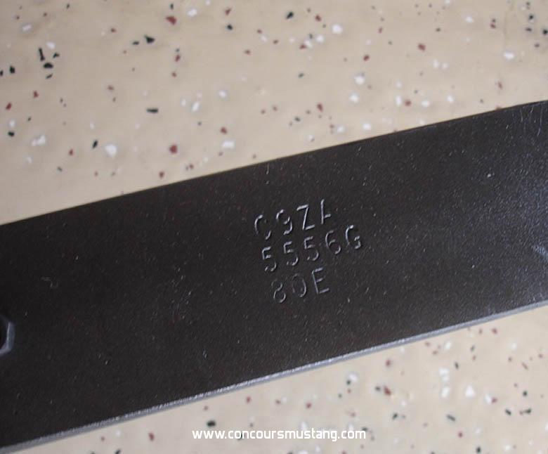

Looking for opinions on spring paint swabs and stripes
No opinion - just what I've found. First example is a 69 CJ Mach one - that doesn't really matter as long as the spring markings match. Reproduced what was found
This example is an original marked spring of those colors. Reversed this time by the guy putting the stripes on at the spring plant that day

I am skeptical of the finish on the reinforced upper shock brackets also . FYI the finish on the nuts is different and the nuts themselves are different design then what is typical on any 69 plant I have observed . If those things are different then the typical there is a distinct possiblitiy that the finish on the upper shock brackets was different too. Some other things like no sound deadener on firewall, black chassis mounts and a few other finishes bring up the distinct possibility that the normal finish's details may have been forgotten in time which is understandable. Just a thought.

Jeff, thanks for the spring paint info!! On the Boss reference, from what I have gleaned in years of tracing my T5 and many other 1969 T5, the suspension is referred to as export, Boss, heavy duty and what not. What I know is the springs and stabilizers and the reinforced shock parts are all heavy duty. My T5 is a 302 2BBL yet carries these springs. The literature says this was done regardless of engine in anticipation of the autobahn speeds

On finishes.
I disassembled this car and have books of notes and photos. Got pretty adept at that as I did the Corvette the same way. No deadener on firewall or under the body, only in the wheel wells. The fasteners were cataloged, tapped died, stripped, re-plated and tapped again to remove excess plating. The brightness of the CAD I and II might be brighter than a 1969 factory but tis what it tis :)
While the phosphate may have stuck better on the shock brackets than the washers but tis what tis is as well.
I have seen info posted saying the shock brackets were black before. They were not painted black when removed for sure, just dirty from driving well over 173k miles.. If I ever get to an MCA event I may paint them but hesitate to given the found finish.
This car went to Germany and then back, appeared on car lot near Ft Knox in mid 1972 where it was purchased.
Years ago I passed a couple letters though the registry owner to all 69 T5 owners and accumulated quite a lot of confirmations and copies of info. Been fun sorting this car out given the T5 variation.

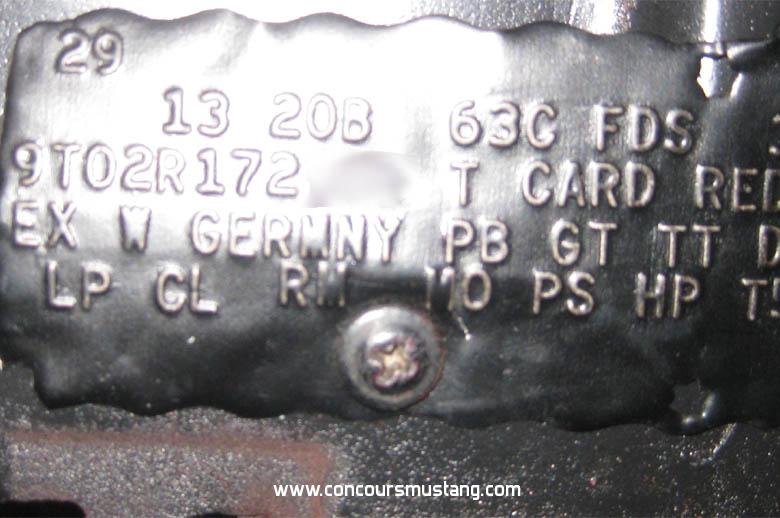

The build tag does reflect this car T5 and it matches from front to back, engine, tranny to build tag.
You didn't post a picture of the left side - does it show the country it was sent to? Have pictures from other examples showing EX WEST GERMANY

On finishes.
Think you'll find that the Mustang and Shelby world is a bit different that the Corvette world. Since we understand that most cars don't make it through 40 or even 10 years untouched or unaltered we also rely on other cars built by the same hands, supplied by the same suppliers and put on the cars at the same time.
If you ever show the car or another owner chooses to follow your lead guess it will be your responsibility ;)  tis what is tis

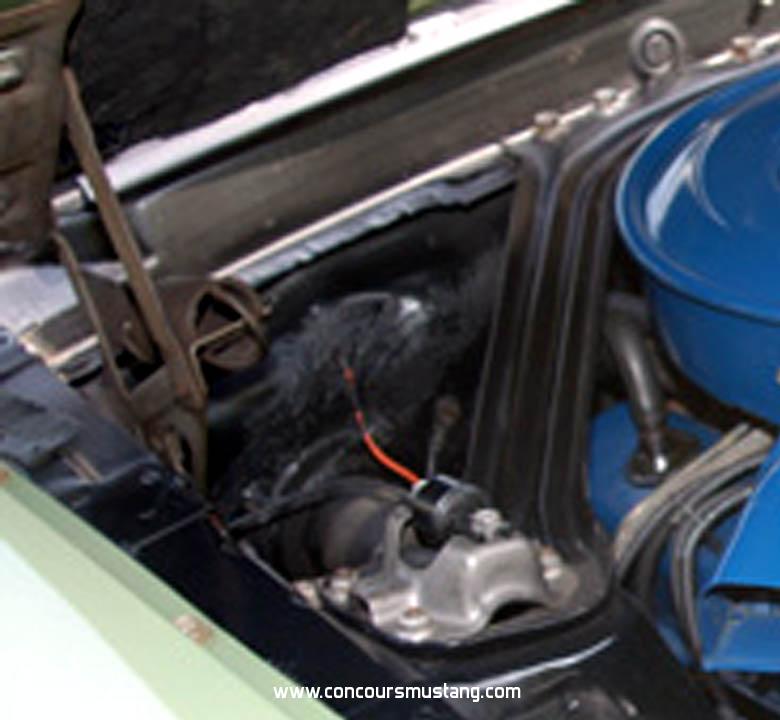

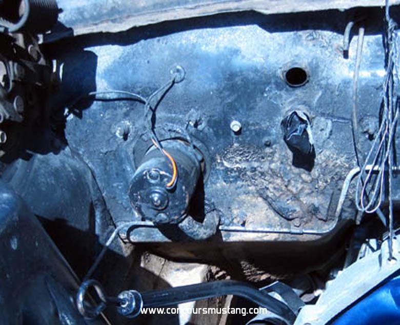

Don't understand why your car would have been skipped over especially considering its planned destination as far as firewall sealant.
Not something was I've seen on other T5s or any export car. More sealer in many cases  A few 69 NJ examples likely from around your cars build date
9T186xxx
9T197xxx
9T202xxx
 As for the shock mounts did you (in your survey) find anyone else with an unaltered car with unpainted mounts?  Know plenty of original cars that went through the same plant that received the same mounts that were black. Think that is why this will often get questioned when the car is out at a show if you choose to take it. BTW did you find the normal paint mark on the mounts that identified the export ones for the plant/line workers
Thanks for share your pictures and cars with us.
Did notice you posted the other side of the buck tag - interesting that it stamped differently from the other 69 NJ built T5 that was built fairly close (little over two months)  to yours

Jeff posted the undercoating near the heater. I thought this was road crap from 200k miles. But I have similar "coverage". Not like they spent a lot of time on this

I am VERY glad you found the spring with the same engineering codes and paint marks. That is actually what lead me back out here, was looking around once again and spotted the 5556 G springs. Great!
