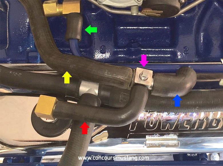

First off, sorry for all the arrows!!!
I have labeled the locations I have questions on,
GREEN ARROWS - DICHROMATE
- Anti Backfire Valve
- Emission Hose T
- Low pressure PCV T stays the zinc finish?
YELLOW ARROWS - DICHROMATE CLAMPS 1-#7 AND 6-#9
RED ARROWS - Spring Clamps
   Are the supposed to be black phosphorus, Zinc, or Dichromate?
Thanks for all your help,
Travis

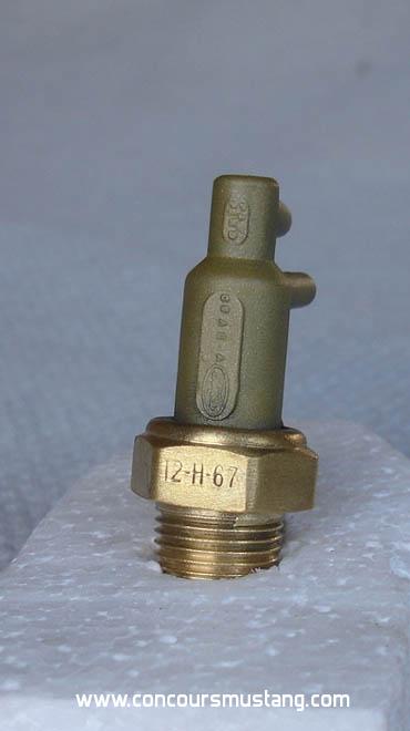

The lid/cover and steel tubes appear to have been zinc plated and possibly once assembled with the body and tubes plugged dipped in dye. Only way I can explain how the whole thing ended up gold since you have the zinc under the dye on the other surfaces but not all. Brass fittings added later.
The tubes take show a greenish gold finish when the hoses are removed like mentioned below
- Emission Hose T
The protected surfaces under original hoses show a goldish green color similar to the finish found on 67- up ported vacuum switches not sure if this is a reaction over time with the rubber (greenish tint) to the dichromate dye like other items made of the same material (PVS, carb bodies ...) it was standard for Ford to require a protective coating since the bare material would turn chalky or pit when exposed to the elements
Yes zinc dichromate like the PCV 90 degree block

The next point IMHO that needs to be addressed is your hose usage and routing of the vacuum/low pressure PCV hoses
You have one hose that is incorrect for your application. Its from another application  - possibly the type of car the piece came from but not a Mustang or Cougar in 67. The assembly manuals, original cars and the MPC all show L shaped hose  you have between the vacuum T block and the PCV block normally is used on engines with out the PCV block and the bend in it replaces the block assembly that makes the change of direction on the Mustang and Cougar 390GT engine. It carries the part number C6AE-6A886-A I believe. Instead a very short section of hose  replaces it.
With that short hose your T block in place needs to be rotated and installed in a different configuration to allow everything to connect. Again this is shown in the assembly manual drawings and is found on original 67 thermactor 390's in Mustangs
Lets try the arrow thing to see if I can communicate it clearing. Your going to have to try a couple of things since I'm not there in person - maybe we can make most of these hoses work. Guess if we have to we can do a phone call but lets get this a try
First your engine with your hoses
With the arrows we should be able to discuss what is next
Green, Red, Yellow, Purple & Blue arrows

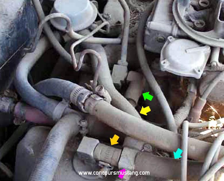

In this picture of an unrestored car we have two different colored arrows to identify two different hoses (that what you have)
Ignore the wrong carb, trans vacuum rubber hose routing, hacked heater hose and the worm clamp (for a start) some PO added to keep the short hose to the PCV block attached or at least try. Sure the hose became detached over an over again - my cars sure did. Have owned and driven daily a number of 67 390's with Therm over the years. Have other examples but wanted to stick with one at this point. This was is from a car that the shop you purchased the parts from had in inventory a numbers of years ago.
Orange arrow & Light Blue arrow
Before we move onto the clamps figured this needs to be addressed first.

First subject - just noticed (going back and forth between factory drawings and unrestored cars your PCV/idle compensator block is not correct for the application. It will work though the plugged hole and the connection orientation will be different.  On and original the hole with the plug (compensator on AC cars) is on the opposite side of the center hose connection. On yours its is not. Guess it could be welded up and retapped on the correct side if need be
Now to the hoses
Though the system (at least the hoses) appear to be from another similar application I think we can make much of it work though the clamp markings/depressions may be an issue at some point.
In an effort to break this process down in understandable steps I believe I would start by
1- Seeing how much better your hose (yellow arrow in your car's picture) fits rotated 180 degrees. Think it will be a better fit. Yours currently does not line up with the anti back-fire valve nipple and the bends in the hose look like they will line up better/more like the unrestored
2- Rotate the PCV "T" around like in the  like shown in the unrestored picture
3- Try the (red arrow in your car's picture) where the blue arrow hose is on your engine. So it will be in the same location as the light blue in the unrestored.

Re: 1967 390 Thermactor clamps, finishes and locations
« Reply #9 on: July 01, 2015, 12:23:04 AM »
Not too sure what you are talking about on this?
I was sure something in the "translation" would fall through :(
Compare the hole for the plug and where all the connecting hose nipples are in the T block (purple arrow) in the picture of your set up and the one in the unrestored.
On your version the plug is on the top - of all the connections are coming in from the sides while on the unrestored the plug hole forms an X if all the connections come in from the sides

« Reply #10 on: July 01, 2015, 12:29:11 AM »
I gotcha!!! Since I ended up having to buy two smog systems. I have the correct one, just like the one in your photo. Its color is supposed to be chromate, right?
« Reply #11 on: July 01, 2015, 12:36:31 AM »
Oh great so your mixing and matching - sort of like me trying to make complete systems out of the crates I have of pieces. Did leave some of them together so I wouldn't have to guess, but not enough of them :(
Great - and yes
