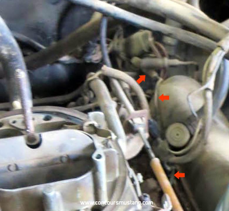

Different engine  - same principle. From a post I was preparing. Don't know if the same solenoid and mount was used on the 70CJ. This is a 70 Autolite 4300.
