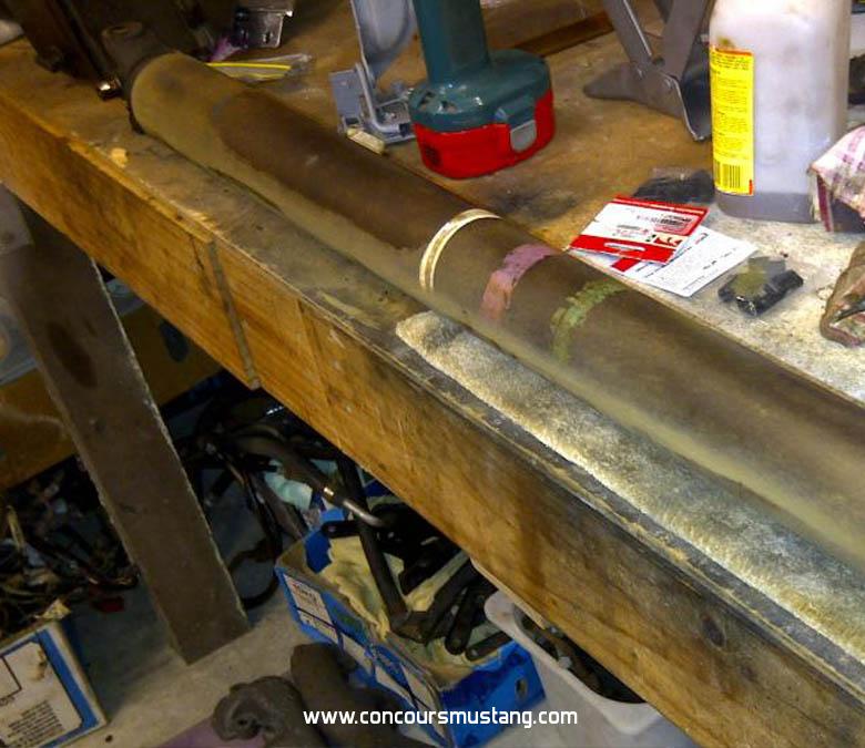

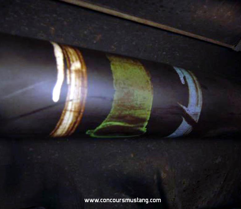

Looked through what I've got and the best I could find was a group of C code Mustangs with 4 speeds built in early June - hopefully there was not a change between April and June.   Its not unusual for these colors to change 2-4 times during a production year.
From front to back as listed on the buildsheets
Lavender - Dark Green & Light Green
The following is an example of location and look of the factory applied stripes (by the supplier) Much messier that what you'll see on some "restored" cars :(
This first one will give you an idea of what the lavender and light green (picture #2 for light green also)  looked like
Dark green is more of a Hunter Green

lol yes from the others post !!! :)
thanks for the picture , that help a lot !

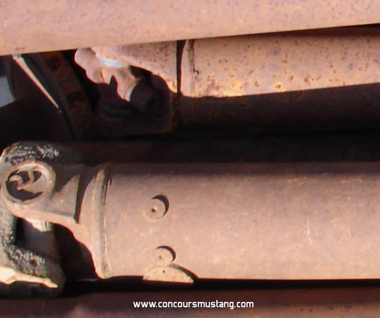

Tube in tube - one yoke attached to a smaller tube inside a larger tube that is attached to the yoke at the other end
Single tube - one piece of pipe with a yoke attached at both ends
second picture ! solide one is same as mine !!

OK, I know I'm working on a 67 with a C4 trans but it looks as though we could match up to this one. I'm using this one picture Jeff posted earlier that looks to be pretty much the same color stripes as used on my 67 with a C4. MPC has both the 68 NON-GT 289/302, 4 speed or c4 auto as using the same replacement number C7ZZ-4602-G, same as the majority of the 67 small blocks and in seeing the stripes in this image, more or less using the same markings (see my attached images below also)
It looks as though I've found a pretty good match on the green color (there are two green dots, one w/more blue...NOT that one ;) ) but I'm off a little on the lavender or pink (see dots on driveshaft) I found these paints at a "free to good home" at church. Crafts paint comes in SO MANY pre-mixed colors but with "soap & water" clean-up, I suppose care would need to be taken on preservation.
Hope this helps others

Hopefully your still at the stage where you still have the paint examples on the tube. If so try first measure our where each one is on the tube, how wide each is and the other details  then try and remove just the top layer of paint from what is left. You can do this with some fine steel wool (only do a section so tape off half of the mark) to preserve it if things don't go well on the side your cleaning
Give the paint a swipe or two and then another until you remove the oxidized and discolored top layer. Wet that with a little water and a truer color should be visible. Get yourself some paints and mix a fair amount (maybe an 1/8 of a cup - you'll need to load up a 1/2" brush for the application one or twice) matching color, place it in a sealed container then save it for after you get the driveline restored.
Matching stock color names from a buildsheet always runs the risk of being off a little or allot but sometimes that is all than one has to work with and the reason some pictures can help in those cases. You on the other hand are blessed with the fact that you have the actual colors to match. Take advantage of that
