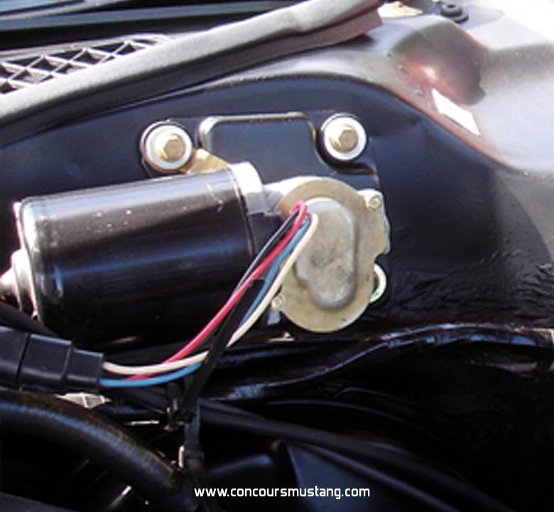

Here is a picture off of a 71 Boss that went through Bob Perkins collection
67 GT S-Code, San Jose, 06/67
72 Mach 1, Dearborn, 01/72

Just a mention but the picture I posted is of an original (very low mileage one) - I rarely post any restored car pictures. If I do - I'll label it as such
