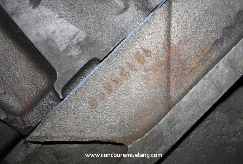

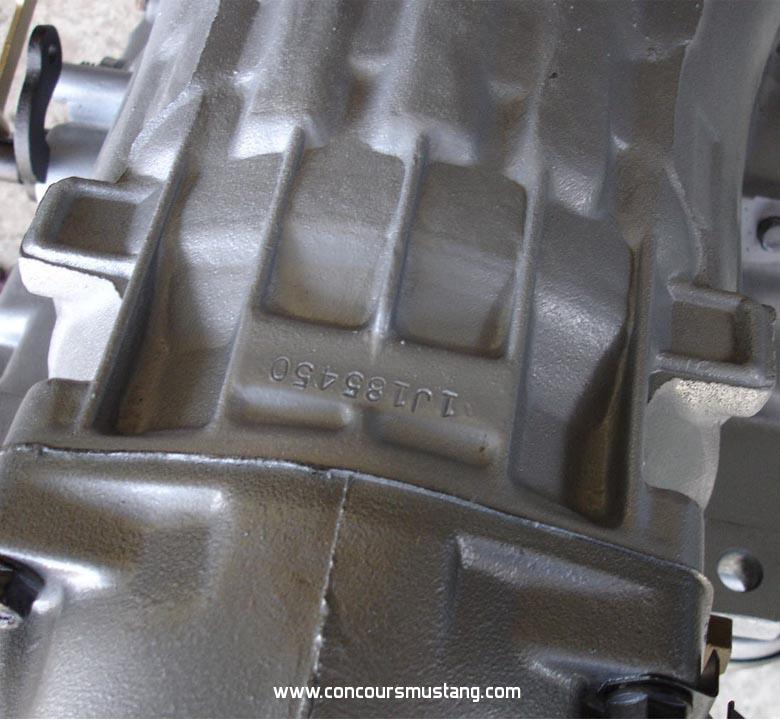

Originally a shortened version of your car's VIN (year, plant and sequential VIN) would have been stamped on your engine block and the transmission.
What type of trans does your car have?

Examples
