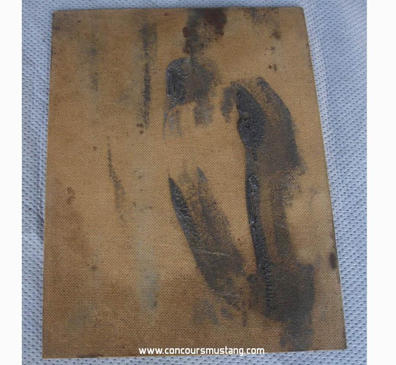

I found 4 samples all measuring 6 x 12 inches. Dearborn Cougar 1967/68, and San Jose Cougar 1968. Looks like 3 dollops of caulk on the rough side to maintain contact with the fuel tank. Looks like the same color of caulk used to seal the fuel tanks.

The caulk and its amount  :D  is typical for factory trunk board installation.

Thanks! Can you tell me where on the tank it was located? It looks like it is about 3" from the front but can not see the RH edge.

Just wanted to caution viewers with other years. Did check today and the size and method of attachment differs between years and (for adhesive) plants.
Measured one from another year today that was almost three times larger than the 67-8
Board though was the same 3/16th" thickness Not easy to find today

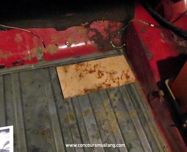

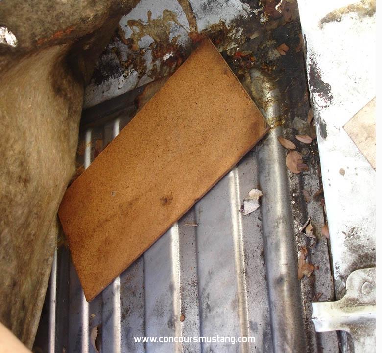

Surprise   8) - found a few picture to add to the discussion
Hope they help in some way
Looks like front passenger side corner is in the lead  ;)

I have noticed upper passenger corner on the ones I removed for 1967-68. Would imagine this to be true for coupe and fastback, convertible boards probably stuck in a different spot of the fuel tank?

Thanks Jeff that one is the money shot! The position is a bit perplexing, the jack rests directly to the left of the spare anchor point and that is where I thought the board would be placed.
I got lucky and found a sheet with the correct pattern on it. I believe that the anti rattle board is made of the same material as the early 67 trunk filler board was made of.

Yes surprised it was not positioned better to protect the tank from either the spare or the jack. Maybe that is why the new years version was made much larger
And yes its likely the same provider and material for the drivers side filler on the 65-early half 67
